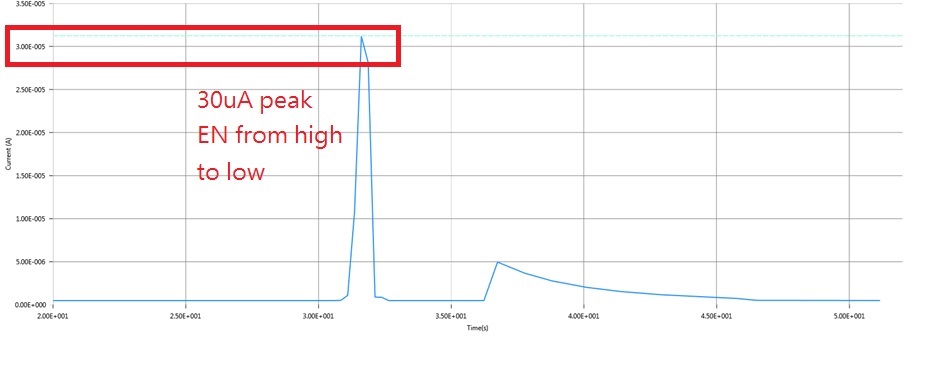

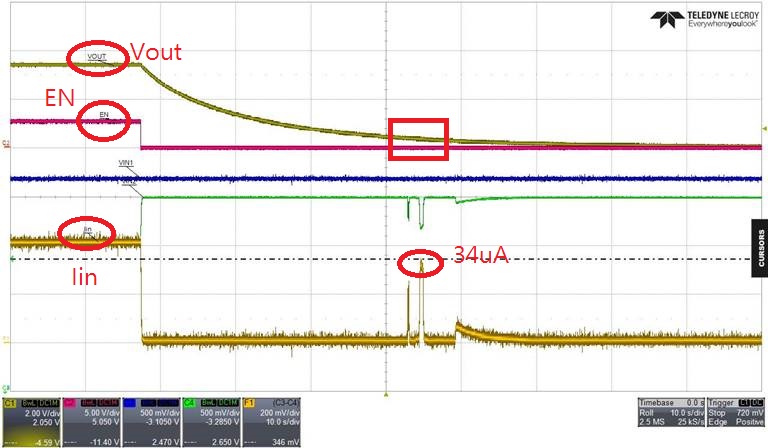

I saw datasheet ISD max is 3uA ,but when I use TPS61021A to control EN H to L ,we will measure a 30uA peak current
May I know the reason ?

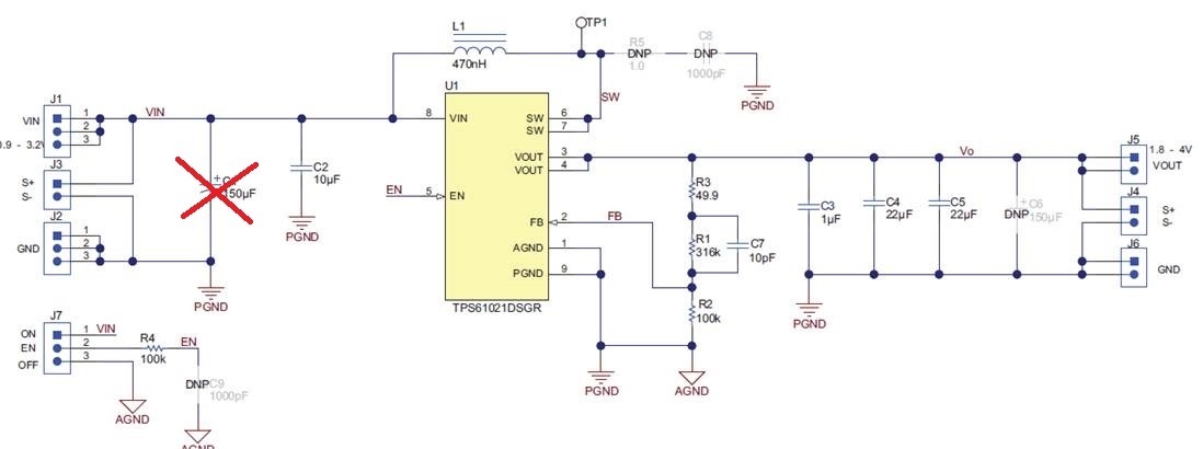

The peak current is measured from EVM and 150uF is not populated
Thanks.

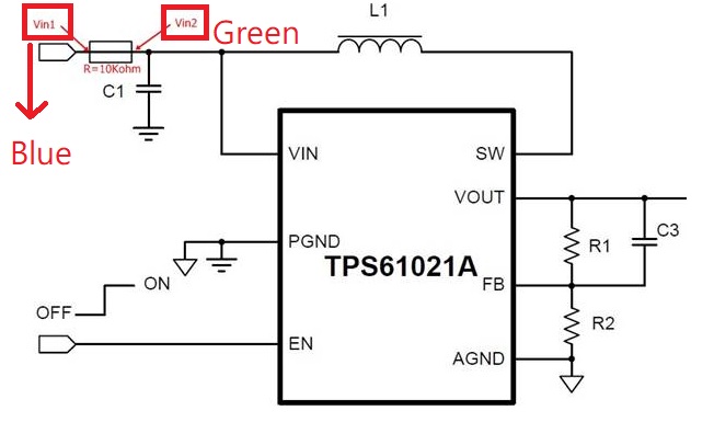

About below figure ,this result test by Tektronix DMM7510 multimeter ,could you help to double confirm again
