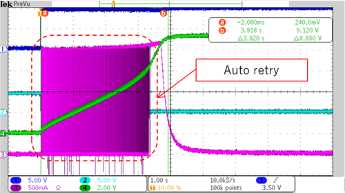

When power is turned on, TPS259241 starts up repeating auto retry.
(Vin=9.5V Iout=2.4A condition)
Please check the attached waveform.
The internal FET when auto retrying is in operation can not be turned on completely.
And This operation is used to limit the current.
Is this understanding correct?
Yusuke/Japan Disty

    What is the output capacitance? and the capacitor on dv/dt pin? Can you share me the schematic.
    The device is starting in current limit mode and resulting in thermal shutdown.
    Rakesh

    Capacitance : 1uF
    dv/dt : 1000pF
    "The device is starting in current limit mode"
    Yes. Customer understands that it is starting up in current limit mode.
    Customers want to know how internal FETs generate heat.
    Is it correct with the understanding that FET is not turned on completely, and it is turned on a little bit.
    Please tell me the mechanism by which the following formula is applied.
    Yusuke/Japan Disty

    In current limit mode, the device regulates the GATE of the internal FET to maintain constant output current. Yes, your are correct, the device is not turned ON completely. The power dissipation becomes (Vin-Vout)*Ilim
    What is the start load value (equivalent resistance)?
    Since the output capacitance is low, Please leave the dv/dt pin open and test.
    Please use the design calculation tool available at www.ti.com/.../toolssoftware to verify whether the device is able to do successful startup.
