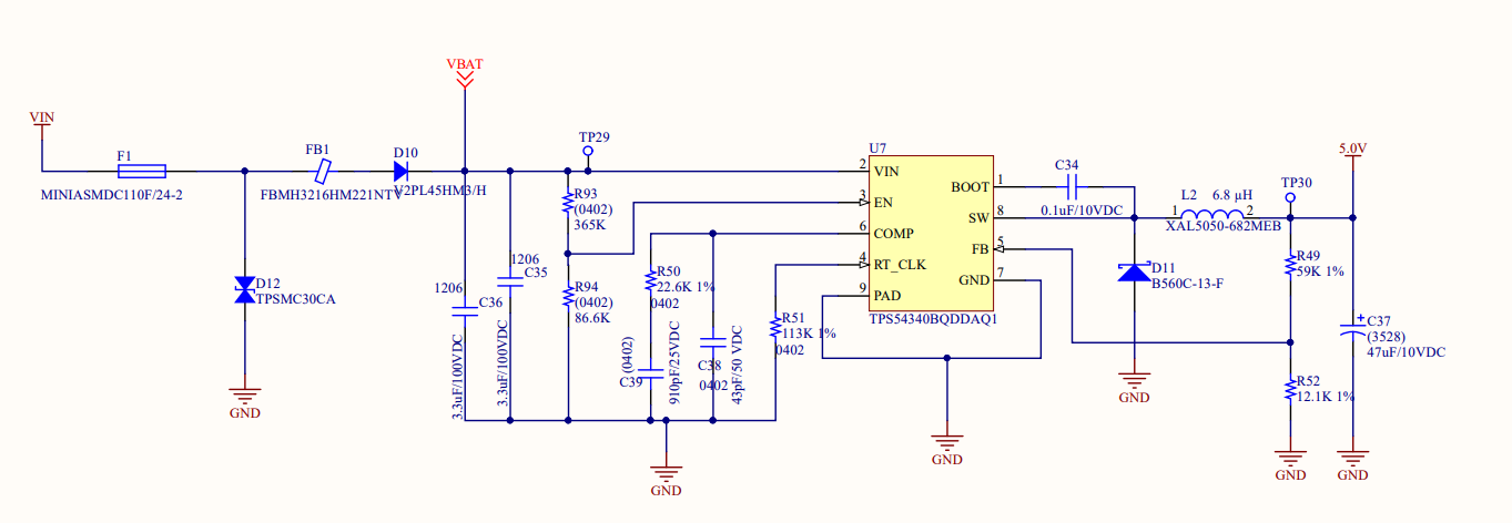

Dear Sir,

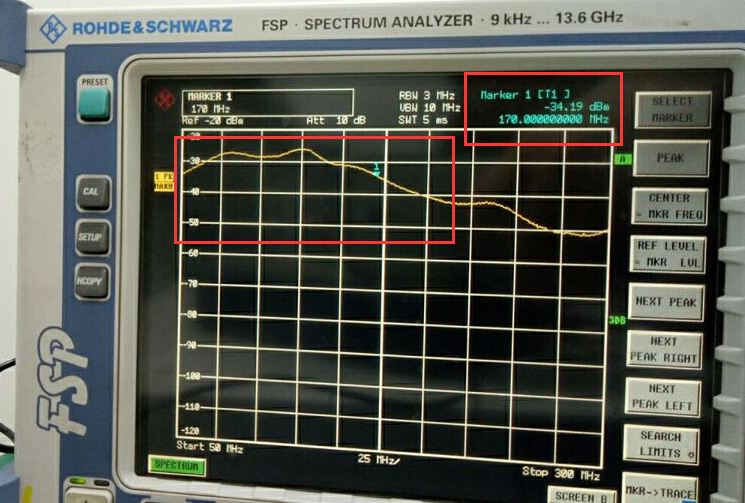

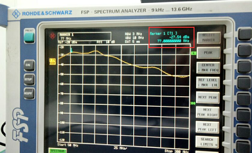

We are facing Radiated Emission test failure issue due to the TPS54340BQDDAQ1, that radiated emissions above the limits at 74.15Mhz , 75Mhz and 171.6Mhz frequencies. Could you please suggest solutions to reduce the radiated emissions? I have attached the test results and schematics of the power supply side.

  • The radiated EMI performace of a buck is highly related to the PCB layout. A few things you can try before redo the layout.
    You can add a small HF ceramic bypass cap (.1uF to .47uF) as close as possible between the VIN pin and the ground pad of D11.
    You can add a snubber circuit from SW node to ground.
    You can also add a small bypass cap (1uF) between Vout to ground.
    The most effective way is to add a pi filter at the input port. It will improve both conducted and radiated emission.
    -Yang
