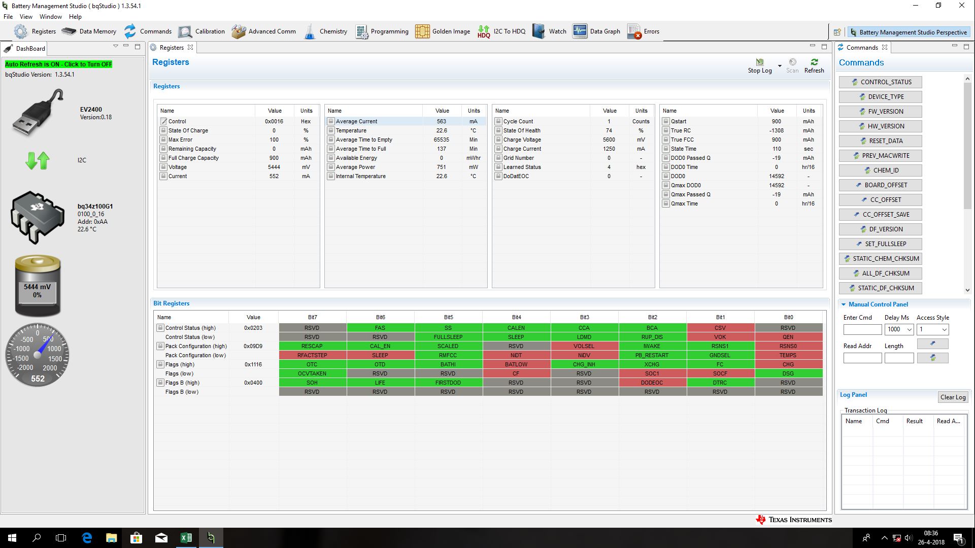

Hi again TI,
I am struggling with the BQ34z100. I've got no certain Qmax value, so followed the steps on SLUA334b, for no close Qmax known. I decharged with a charge terminal which is capable to decharge.
After that I went to charging with the BQ25703A EVM board. When the current dropped under 100mA I expected the FC bit to set. However, after 3 times waiting the taper window of 40 sec, still nothing happend. I didn't dare to leave it sort of charging through the night, so disconnected it and ask for help. Tonight it won't be charging, but I will keep logging.
Attached hopefully enough info with log and data memory export file.

In the datasheet I found:
Full charge is detected. FC is set when charge termination is reached and FC Set% = –1 (see Charging and Charge Termination Indication for details) or StateOfCharge() is larger than FC Set% and FC Set% is not –1. ALERT is enabled when set.
There is probably my problem. State of Charge didn't change at all and FC Set % is at 100. Why didn't those change?

    Does SOC stay at the same level ? Would you send the reset command(0x0041) or power-on reset after changing the cell voltage. SOC should be changed if the gauge works properly.
  • Thanks for your reply. The SoC stays the same, 0. But I do not remember if I did reset the gauge after calibrating the voltage.
    VOK and QEN are still set. Can I do the discharge part when they are still set?
    Today I will send a reset command and discharge the battery. Then tomorrow, I will charge it and report back if the SoC will change then.
    edit: Ah I see VOK isn't set after reset.
  • I just started charging, but it doesn't yet look like the SoC is going to change. I charged about 60 mAh and the now 'known' Full charge capacity is 920. SoC is still 0. and FC set% still 100. I will keep charging, but I don't think this was the solution.
    edit: ready charging, but still no FC flag set. Attached a screenshot, log and datamemory export.delen.zip

  • Yesterday I found the gauge magically standing on 65% SoC. Hoping this would mean the SoC is really adapting again I started discharging and continuing the calibration. Attached, again the logs, I'm still busy charging now with the BQ25703A.
    In the discharge log you can see the SoC lowering from 65 to 30 and then becoming 0. The charge, again, does nothing with the SoC. Also attached, the begin screen when starting to charge.

  • Hi ka, Did you use the correct chemID for your cells ? What is your cell terminate voltage in DF. RM dropped to 0 when the voltage reached at terminate voltage or predicts that it has no capaicty remained. There are various reasons and if chemID is not matched correctly, RM/FCC value reports incorrectly. Please, use the right chemID and run the learning cycle before starting the test.
    I made quite a few changes today and trying to do a new learning cycle today and tomorrow.
    Also with the previous settings I tried higher charging settings and this helped sort of. I still don't know if it is going to be ok, but this is what happended yesterday.
    I charged a not completely empty battery with higher charger settings and SoC seemd to stay zero again, however, when my charging current didn't change anymore at 377 mA, the SoC began changing a little bit. About 10% every quarter hour. In this time, till 100% (it didn't go further), I saw the voltage drop a few times, but no FC set. Till it came to 100%, then the FC was set.
    Max error and those things didn't change after a night of rest.
    Attached the logs during charge and after the night.

  • The results of all my changes.
    I resetted the whole thing. reprogrammed it and programmed chem 6104. (oh shoot, I just now see it is 24000 mah, instead of 2400 I thought to read.), till now I used 6103 (still a better fit with 2600 mAh it seems). What does the chem programming do?
    Attached my data mem.
    data mem 06.gg.csv.zip
    I charged the battery and the SoC changed. When it reached 100% it soon gave an FC. However I kept charging to make sure it was full, True RC didn't even reach the kind of values that should be. Available energy also soon took his max value and didn't change anymore (1877mWhr). When my current stayed quite stable on a low current I stopped charging. Since then, now about 18 hours ago, OCVTAKEN has not been set. What should I do?

  • Hi ka,
    ChemID has the OCV and resistance information. So, the capacity information is not important to select the matched chemID.
    You have to use the matched chemID with your battery before charging or discharging. TI provides the GPC Chem tool to find the matched chemID here.
    http://www.ti.com/tool/gpcchem?keyMatch=gpcchem&tisearch=Search-EN-Everything
    If chemID is not matched with your cell, it has high error rate. So, the first step is to use the matched chemID.
    Once you find the matched chemID, you have to run the learning cycle. It will update the Qmax and Ra value. Every test is meaningful after learning cycle.
