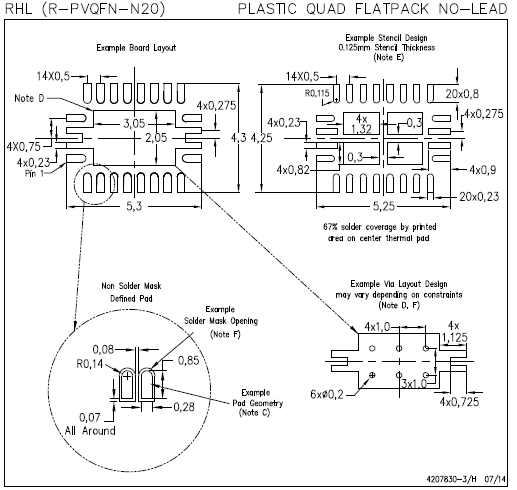

My customer has bq24105-Q1 datasheet and it shows "Example Board Layout" and "Example Stencil Design" as the following.
These are different from current datasheet in web.
1)
Could you tell me the background of updating?
2)
Is there any concern if my customer designed with their datasheet (above)?

  • Hi Steven-san,
    My customer is currently designing their board and wants to know the following as soon as possible.
    Could you support it until a few days?
    Yaita
  • Hi Yaita-san,
    There is concern over the solder paste filling the vias that are on the layout, which is why in the new guidelines, the vias are not covered by solder paste.
    There are two approaches for this:
    1. Keep the same guidelines as before, but be sure that the board fab fills the vias, that way the solder paste stays in place.
    2. Change the layout and stencils with the new guidelines, which will prevent the vias from filling with solder paste.
    The less design intense approach is #1, you can keep the same guidelines, but make sure the vias are filled before applying the solder paste.
