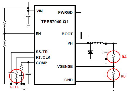

Customer wants the following information for evaluation of application.
1.VSWNSE resistor (RA) open condition
  Please tell me the operation of TPS57040-Q1 under these conditions.
2.VSWNSE resistor (RB) open condition
3.RCLK resistor open condition
Could you give me your advice?
Yusuke/Japan Disty
  • 1.VSWNSE resistor (RA) open condition
    YZ: If RA is open, VSENSE has no information of Vout. The feedback loop will try its best to drive Vout up, as a negative feedback loop should do. Then you will see Vout being driven to close to Vin. Your load might be damaged if they are not rated upto Vin voltage level.
    YZ: If RB is open and RA is connected, VSENSE = VOUT. The control loop always regulate VSENSE to 0.8V, so VOUT will be regulated to 0.8V as well. If both RA and RB are open, it will be the same as RA open condition in '1'.
    YZ: The oscillator will not work properly is RCLK is open or short. The frequency is set by the current of an internal voltage source applying VRT to the RT pin. Current seen by the pin: VRT/RCLK set the frequency. Vout will not be regulated if RCLK is open.
