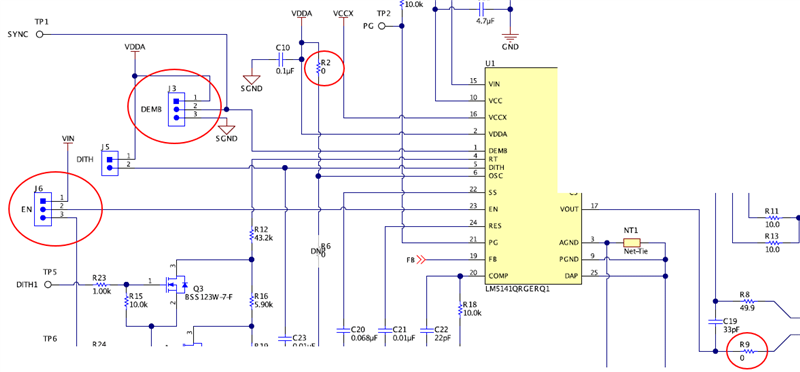

Customer wants the following information for evaluation of application.
1.DEMB pin open condition
  Please tell me the operation of LM5141-Q1 under these conditions.
2.OCS pin open condition
3.EN pin open condition
4.VOUT pin open condition
Could you give me your advice?
Yusuke/Japan Disty
  • Hello Yusuke,
    See answers/responses below.
    1. DEMB open - no pull up, pull down, DEMB mode undefined, part will still function.
    2. Osc Open - undefined, If OSC is <0.8V at startup fs =440kHz, If OSC>2.0V fs=2.2MHz
    3. EN pin open condition - No Output EN voltage must be > 2.0V to enable part
    4. VOUT pin open condition - Vout 0V, Unable to sense inductor current.
    Hope this helps?
