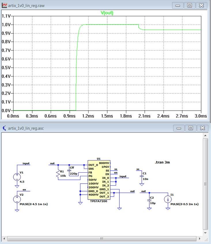

  • Hi Jason: Per customer
    I attempted to use the PSpice model but I get some erroneous results with it. When I introduce a 500mA load I see a 0.5V drop from regulation (Vin=4.5V). So I’m not sure if I can trust the model or not. Do you know why this would be? I captured a screenshot of what I am seeing at the bottom of this email.
     The stage right before the LDO will be a 1.8V switching converter (4A).
     Do you know what the bandwidth of the TPS7A7200 is?
    Naser
  • Hi Naser,
    I agree, the simulation seems to have a problem with PSPICE model. For the loop response, from the datasheet, there is no clear chart that we can use to estimate. The common bandwidth for LDO is around 1-2MHz; the datasheet has discussion on bandwidth, but there is no value mentioned. If you really need to know the bandwidth, we can run an estimation using load transient. Can you share me with the switching converter part number? I can take a look at the output impedance of the converter as well.
    Jason Song
  • Hi Naser,
    In order to ease the concerns about stabilities problem with the added impedance at the input, we can estimate the bandwidth of the LDO to be between 1MHz to 2Mzh. As long as you have the LC frequency (1/2pi √lc) within 200KHz or above 2-3Mhz for this device, we should be good. We just cannot have the LC frequency too close to the bandwidth of the LDO because the worst phase margin is around the bandwidth. If you can estimate the inductance from the layout, we can use the value to pick the input cap; we can either do a small cap up to 1uF with careful layout or we can do a tantalum cap which will limit the LC frequency inside the loop but still far from the bandwidth.
