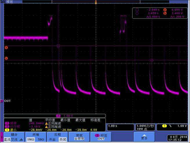

BQ51013B Vout  of the Smart phone can not work normally at operation mode. For example : browse picture, internet, play app game...
We check BQ51013B EN1 EN2, always keep "Low"  And I measure the waveform of BQ51013B Out & RECT.
Below is Out. You can see BQ51013B Vout drop after 1s.

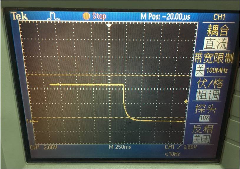

Below is RECT.

  • This type of behavior can be caused by several problems, TX coil to RX coil spacing, RX coil tuning are some.
    Could you send schematic on the RX and info on the RX coil?

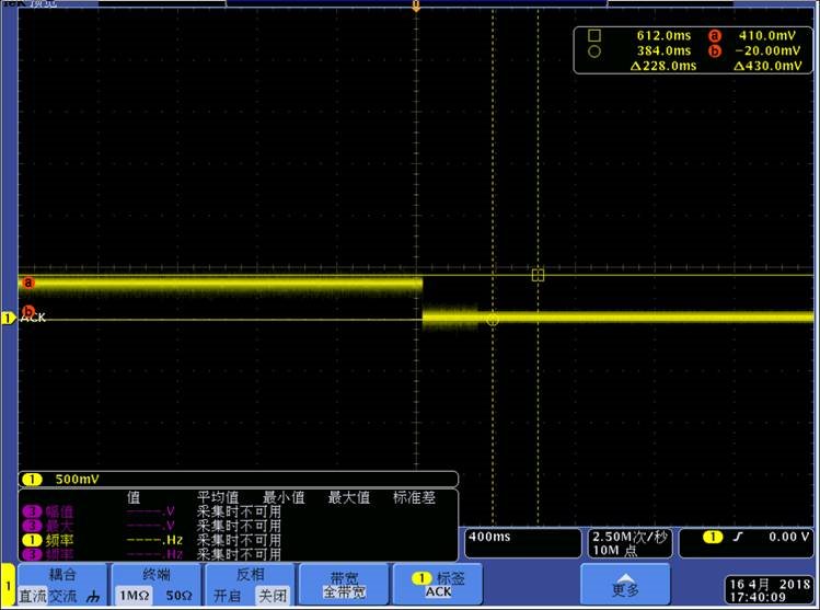

    Standby mode : Smart phone turn on and do nothing.   Put phone on the Qi Rx then battery is charging.
    Below is FOD waveform.   FOD voltage is 0.43V in normal.     FOD voltage goes to Low  (0V) in abnormal.
  • Hello
    RX FOD is a measure of the output current and will represent power received by the RX. The current at ILIIM is output current and is sampled by FOD pin. This is then converted into a digital word and set to the TX for FOD.
    The FOD function needs to be calibrated.
    As a quick check the FOD resistor can be increased in value to prevent FOD fault. Output current limit is set by ILIM to ground resistance. If FOD resistor is increased, ILIM to FOD resistor can be decreased to keep current limit the same.

    Could you tell me how to calibrate FOD function.
    Now RLIM = 110 ohm, RFOD = 180 ohm
    And I check my customer, Ls' value of the coil is 8.7~9.62uH@100KHz
    How about the RX coil tuning (C2331, C2330 and C2332) is 300nF, is it all right ?
  • Hello
    For Ls' value of 8.5uH 300nF is about right and 8.7 to 9.62uH will put the tuning freq a little low, see section 8.2.1.2.2 in data sheet.
    For FOD tuning see:
    www.ti.com/lit/zip/sluc577
