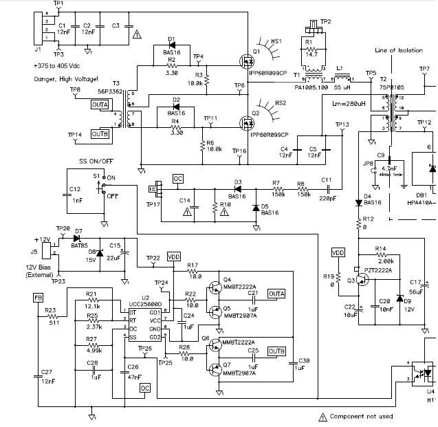

UCC25600: When the switching Frequency is about 280KHz or 300KHz, it's in Continuous mode, and the UCC25600's temperature is very hot, 110'C.
Part Number: UCC25600
Hello!  I design the UCC25600 according to the datasheet's reference drawings, the GD1,GD2, then Push-pull transistor of totem, then the driver transformer, then the NMOSFETs, then the power transformer.
When the switching Frequency is  about 100KHz,  the UCC25600 works normally.
When the switching Frequency is  about 280KHz or 300KHz, it's in Continuous mode, and the UCC25600's temperature is very hot, 110'C. Why? I haven't find the reason.
