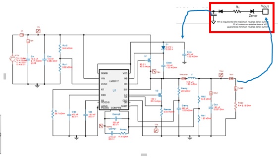

"Figure 18. External VCC Supply For 14.5 V <V OUT"
The circuit input to VCC is posted from VOUT, via Zener Diode.
-Q1: Is the circuit of Figure 18. necessary? (must  applying the circuit ?)
(In the WEBENCH simulation result, the circuit of Figure 18 was not applied.)
-Q2: What are the advantages of applying the circuit in Figure 18.?
-Q3: Using the circuit in Figure 18,
I think it will collide with the VCC output terminal (internal LDO: 7.6 V typ.),
Should I disable the internal LDO on the VCCDIS pin?
- Q4: Can you suggest a recommended circuit for me?

  • Hello Shing,
    Figure 18 is not absolutely needed. Figure 18 is used should you wish to reduce power dissipation in the device. This is the advantage.
    Should you decide to supply VCC bias from the output of the converter to reduce power dissipation, you will need to implement figure 18 circuit. There is no need to implement through VCCDIS, please follow Figure 18, should you wish to implement?
    Hope this helps?
    David.

    zener diode design:
    Vout:24V - VCCout:7.6V  + Vf:0.7V = Vz:15.7V  is zener voltage
    Is this true or false?
    May I haver your comment?

  • Hello Shing.
    Vout-Vz - Vfwd = External VCC voltage.
    Vout = 24V
    VZ = 12V
    Vfwd = ~0.5V
    Where External VCC Voltage>VCC
    External VCC Voltage =11.5V.
    hope this helps?
