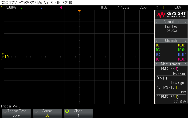

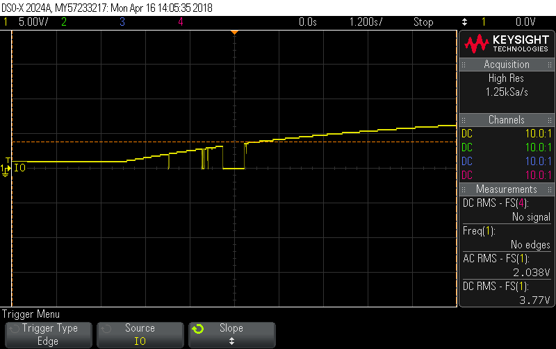

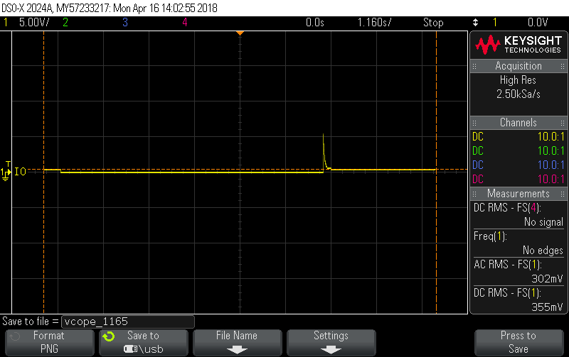

Hi All,
  I am using the TPS40170RGYT for the below configuration,
Input :45 -50 VDC
Typical: 47.5VDC
Maximum Output Current: 8A
Output Voltage: 35VDC
Switching Freq: 197.239 kHz
While performing the fist power ON itself the output voltage observed as 0.3VDC instead of 35VDC . Further subsequent verification the IC getting abnormal heat & observed at the SW pin w.r.t GND impedance was 5.7 Ohms.
Removed the IC & verified the impedances for the below points w.r.t GND,
LDRV-202.8 Ohms
VBP-14.3 Ohms
SW-5.7 Ohms
HDRV - 72.6 Ohms
BOOT - 4.9 Ohms
Please suggest the what is the impact to make the output to get short with ground & attached the schematic for reference.
Looking for the valuable feedback.
Note: I checked in web bench design & I am able o get the output voltage as I am expected.
