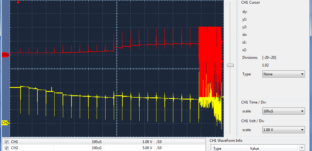

Very strange issue proven software other vendors gate drivers does not cause large voltage surge during Cboot charge cycles. This issue refers to 3 phase commutation and 24VDC bus supply rising to over 90vdc with inverter loaded or not. A custom PFC was resolving 80v-90v PWM surges controlling DC bus voltage. That was the only way Cboot cycles could ever succeed let alone FOC commutation drive a connected motor to 7600RPM.

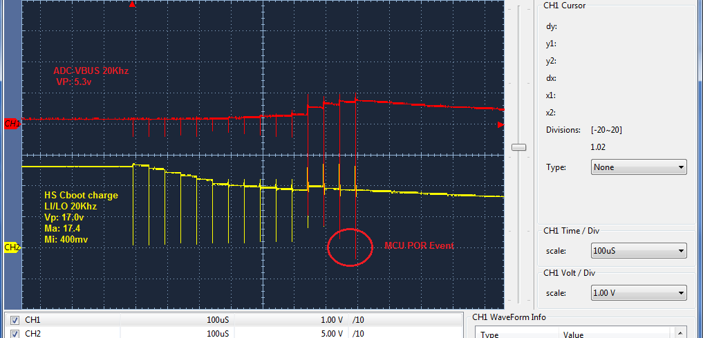

The PWM frequency 20Khz driving 500ns Cboot duty cycle (1%), user settable charge time 1-255ms. Capture below taken single phase (1/2 bridge), all phases resemble similar pattern though signals cut off in 2ms when PWM fault handling has been enabled. Otherwise the 500ns Cboot pulses POR the MCU very abruptly.  UCC pin 4 (EN) was kept high 3v2 (enabled) at all times of this testing.
How could HO drives stay on during Cboot cycles when the MCU PWM control block keeps all 3 HI (low) during Cboot cycles? Do we not expect H0 side should always be low during Cboot cycles or have I missed something in how 1/2 bridge shoot through occurs? Perhaps these 3 gate drivers are messed up in some way and do not follow proper 1/2 bridge switching conventions. The LO side gate drives pulse rising edge from ground producing the odd wave form below. The LO side seems correct in my opinion but not HO staying active during Cboot cycles so the HO single is some how being inverted.
CH2: ADC0 channel input reporting DC voltage. Signal represents 70-80V peaks from 24VDC supply low/left side of signal prior to undesired POR of MCU, far right.

    So before switching, it looks like your Phase A Switch node is floating around 13V as we saw previously. It then goes up and clamps to 24V as you switch the low side, then bounces between 24V and ~10V till forced MCU POR.
    I'm interested in seeing the HO-HS voltage during this event, at a smaller time scale where we can see individual switches. Also, could you post your drive-side schematic with bootstrap cap and resistor values?

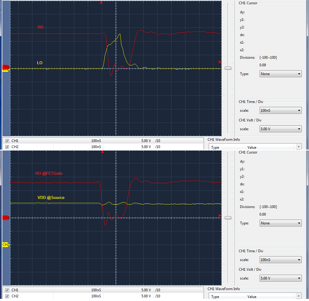

    I was able to tweak pre-charge pulse width, produce 105ns falling edge pulse aimed toward ground. The HI drives are kept false and all three phases LO pulsed 105ns. The original pulse width edge fell near 50ns and never caused this issue, fact I caught UCC produce 50ns pulses 1 time only. The odd part is the UCC would not repeatedly produce 50ns pulses. Hard to imagine the UCC is behaving so badly when most all design precautions were followed. Also tried to produce a wider pulse (200ns) but it seems more destructive. Seem to recall 30ns pre-charge pulses were being produced in the past when 12.5Khz pre-charge pulse width set 1% PWM duty.
    So why has UCC been restricted to 100ns LO and still function in TIDA-00778 is more the question. The disruption in the 24v switching power supply from even 100ns pulses the TIDA engineer should have reported, less he simply tested with linear 300vdc supply? Never should first test PWM drivers at high voltage prior to low voltage testing in any new design, would have revealed such looming disaster as I report here. The amount of DC supply bus disruption in that Cboot charge cycle is abhorrent! Even parallel 680uf caps can't stop the impending surge.
    Odder yet a 50ns pulse width produces the same 100ns pulse when LO/HO should ignore the pulse entirely according to datasheet. Hard to imagine the ADC 24v Bus voltage rings negative from 220mv to roughly -6v after changing pre-charge pulse width 100ns to ground. MUC often POR's immediately upon the 100ns return to 13v.

    Sorry to inundate with so much info, perhaps you guys have a better way to pre-charge Cboot that does not cause so much spiking of DC Bus voltage? The capture pre-charge is set for 20ms but never gets that far before MCU POR event stop it dead. The red trace is monitoring 24VDC bus voltage through 120mohm ferrite bead series to BusVoltage: +24v_(o)_510k - 510k -----trace---- 6.8k to ground, 0.1uf ceramic cap to ground decouples near the MCU. Not sure why yellow spikes start to rises near the time of POR event but the negative red spikes are killers.
  • BTW: Gate drive captures above HO is not instructed low by MCU, it is being discharged by LO instructed low by MCU and current path high side FET 20k gate to source. Had to think about that after wondering, what is going on there.
  • Below is another odd capture, note the sporadic oscillations occurring @500kHz near the end just as MCU has POR event. Have to wonder if HO/HS 20k shut off resistor is causing this since it is not on the FET gate. Required for parallel FET's a 20k shutoff is placed across UCC pins 11,12 with a 16v zener parallel to 20k limiting GS voltage below FET 20v Max. Tina PWM transient analysis of the parallel FET did not indicate such oscillations when short PWM duty cycle was being presented to HI/LI.

    Also, when HO is low, it is pulled to HS internally. When LO is high, HS is pulled to ground through low side FET - and HO follows. So HO pulls to ground through the UCC - not the 20k G-S resistor.

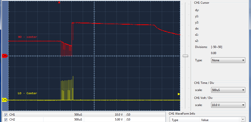

    Every time EN is lifted, after 150us Lo turns off and HO seems to rise from 10v up to 24v during Cboot charge cycles. That seems to drive high side FET to ground as LO shut off but it might just be the Cboot is fully charged after 150us? That behavior would seem at odds with how it always required 35ms or longer to get a full Cboot charge with other gate driver. The MCU fault protection is kicking in at 200us and charge period can go a bit further as capture above shows when Fault protection disabled. That was causes the 50-200KHz over voltage oscillations lock up the MCU even before open loop commutation begins.
    Either these gate drivers are bad for some unknown reason or some kind of errata has been discovered here.
  • Seemingly good evidence HO is staying active as Cboot charges from LO pulses.  HS should then remain near ground and not return to B+ as it is doing.

  • Finally the center 1/2 bridge seems the culprit of the other two partners. Center 1/2 bridge is rising HO up to B+  during Cboot charge cycle for unknown reasons.  Previous captures were taken load attached, hindsight may have masked a 1/2 bridge faulting more often than the others.  Either way all 3 report over voltage faults even with no load attached may be due to this sudden jump of HO during Cboot charging.
  • Hi BP101,
    In this most recent capture, HO is seen to rise up to B+ (25V) after the 500 us Cboot charge cycle from the low side. Can you check each phase HO-HS differential voltage during this sequence to determine if one of the FETs is being switched, or if it is another current path? And yes, one phase could cause the overvoltage fault on the other phases assuming the motor is a Wye load, connecting the phases together.
