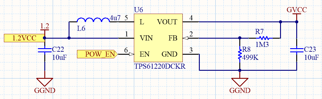

Hello!
I'm trying to make this part work. Vin is 1.2 V and expected Vout is 1.8V, but it's about 0.8V
Inductor: LQH3NPZ4R7MMEL
Both capacitors are ceramic. Does it matter which high level value on EN pin? Now it's 3.3V.
Also can I use it for step-down conversion? Like 3V3 at the Vin and get 1.8V at Vout?
