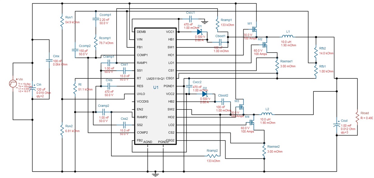

Hi
Its web design output for output of 12 volt and output current of 25 ampere.
Can I use hall-effect sensor instead of Rsense1 ?
