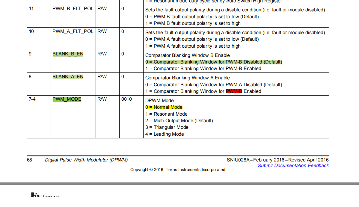

UCD3138: About void init_ipri_cycle_by_cycle(void) Function problem in UCD3138 full-bridge hard-switch firmware
Part Number: UCD3138
Hello, I'm learning UCD3138 full-bridge hard-switch firmware, I have questions about void init_ipri_cycle_by_cycle(void)
Void init_ipri_cycle_by_cycle(void) // Analog comparator 3(AD04 pin)
Dpwm0Regs.DPWMCTRL0.bit.BLANK_A_EN =1;
I think the awareness of this sentence should be Comparator Blanking Window for PWM-A Enabled,
But  "UCD3138 Digital Power Supply Controller The Technical Reference Manual is a Comparator Blanking Window for PWM-B Enabled.
I think the manual is wrong here. I don't know if I understand it right?
