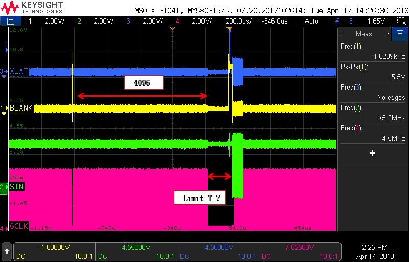

I have a question about TLC5941 , Cuz my LED system is blinking !
1. My GSCLK is 5Mhz , Xlat is 30hz (GS data refresh rate) , IREF = 620 ohm , DC = 6'b000100 , and every pwm cycle is 4096 except one cycl isn't 4096 ,
    in this condition , when I set gs data = 12'hfff  it won't blinking  but when I set data below 12'h500 , it will blinking !
    Here is my waveform , thanks a lot !

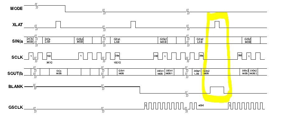

  • Hi, Rafe,
    Eveytime after you sent XLAT pulse to latch new GS data, please send a BLANK pulse to reset the GS counter.
    You can refer the the following figure:
    One fast way to check it, you can connect the BLANK and XLAT together.
    Please let me know if this solves your problem.
    Thanks.
    Kenneth

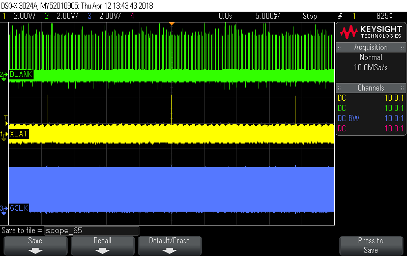

  • Hi Kenneth ,
    First of all , thanks for your reply ~
    I know when xlat pull high blank should pull high ,too . In my case is also like that .

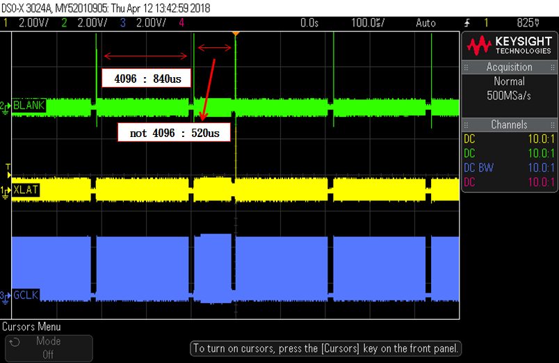

    My xlat is following Video signal (vsync) , which is 30Hz.  If I sent only 1*4096 GSCLK to fill the frame (33.32ms)  , it will blinking .
    So , I sent n*4096 GCLK  to increase the numbers of pwm cycle . But the last pwm cycle isn't 4096 GCLK then Blank pull high (just like figure 1) and the LED is blinking .
    What should I do ?  Because it's difficult to let n*4096 GCLK = 33.32ms , so in my case , the last pwm cycle isn't 4096.
  • Hi, Rafe,
    Understand your application.
    In your case, since 520 us is not a complete duty cycle, so when you use gs data = 12'hfff, the out are always ON and there is no difference. But if gs data=12'h500, since the last duty cycle, the out are not the duty you want to set, then it blinks.
    To solve your problem, there are two ways:
    1. If Vsync signal can be adjusted, you can use another frequency to make sure you have n*4096 GCLK, for example 30.5Hz can achieve 39*4096 GCLK.
    2. If Vsync is fixed, you may need to increase GSCLK frequency from current 5MHz to higher like 20MHz to decrease the last GCLK period.
