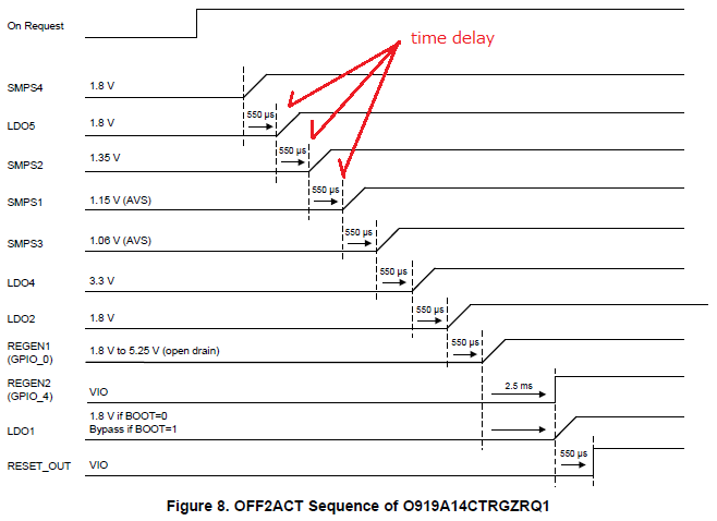

  • Hi Natasha-san,
    Thank you for your support.
    Also, if writing a script, the sequence will be slower that if using MSP firmware or the preprogrammed start up sequence.
    Could you tell me which timing is "slower"?
    Does it mean time delay between each SMPS/LDO power-ups as the following?
    Is it possible to adjust the time delay? (It is ideal for my cusotmer to adjust the delay.)
    Yaita
  • Yaita-san,
    If you write a script, there will likely be a minimum of around 10ms between each rail starting up, as you are limited by the speed of the computer. If you write firmware on the MSP, the processor can directly send the power up commands and will be in the range of 100s of us. Then, in the firmware, you can adjust the delay as you would like.
    Nastasha
