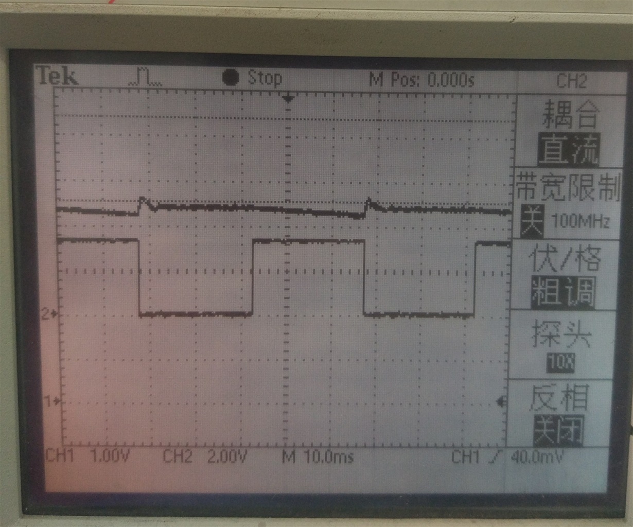

BQ24297: The charging is abnormal, the STAT pin quickly changes state
Part Number: BQ24297
Charging is not normal, the STAT pin quickly switches state, the period is 50ms, the waveform on the photo, the square wave is STAT, the other waveform is the battery voltage, the nominal charge voltage of my battery is 3.35V, the configuration is 3.336, the charge termination current 256ma And 128ma, both tested, the same problem occurs.
