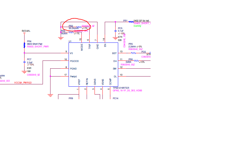

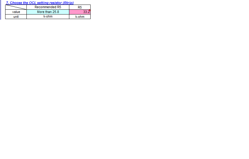

1. Customer use TPS51219 design tool, the value is calculated 25.8A. What is the several times the output current ?
2. Per TPS51716, OCP (PR152) would like to be decreased 1.5 times to output current. What is the suggested value? Thank you.
