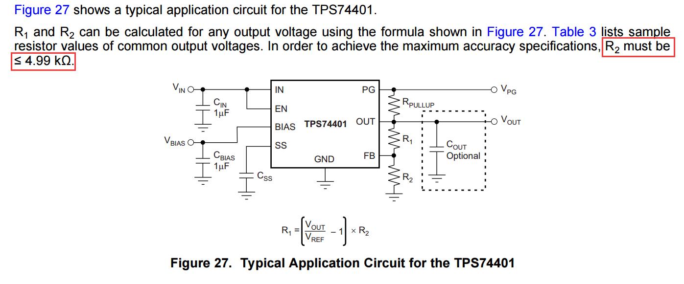

Hi, Experts:
By reading the datasheet of TPS74401, in section 8.2.1, the datasheet mentions that R2 must be less or euqal than 4.99K.
May I know the reason behind this? Is it related to resistor noise or resistor accuracy? Detailed explanation is highly appreciated!
