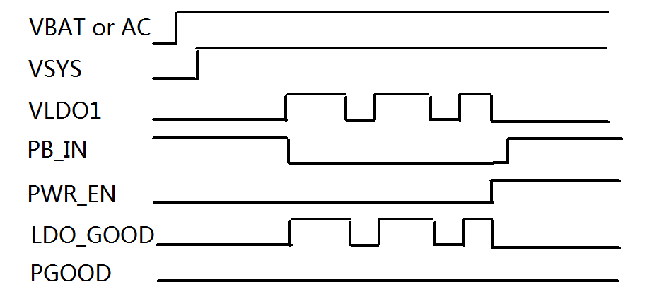

Dear experts,
We met power-up issue with TPS65217C. We can measure correct SYS voltage after sourcing power to VBAT(3.6V) or AC(5V).
We connect SYS to VIN_LDO as recommanded. From the datasheet, LDO1 voltage should come out directly with SYS voltage, but we cannot measure that. (There is no loading on VLDO1)
When we hold PB_IN low, we saw 5s + 3s cycle which looks similar to "Wait PWR_EN timeout" and "PB_IN reset":
-in 5s period -> LDO1 output is 1.8V, LDO_GOOD is high, PGOOD is low.
-in 3s period -> LDO1 output is 0V, LDO_GOOD is low, PGOOD is low.
-once we pull PWR_EN high, the LDO1 output drop to 0V.
-if we pull PB_IN high, after this 5s period, LDO1 output drop to 0V and never go back to 1.8V.
 Could you help us on this or let us know if you need extra INFO or experiment. Thanks very much.
  • PB_IN has a 50ms deglitch time and does not need to be held low for the 5 second period. PWR_EN must be asserted high before the 5 second timeout, and can even be asserted before the PB_IN event.
    If PWR_EN is not asserted within 5 seconds, the device will return to off mode, and LDO1 will be disabled. Figure 24 in the datasheet has further details on the internal state machine.
    Other faults such as a UVLO event on the input or overtemperature condition could also lead the device to turn off.
    Rick S.

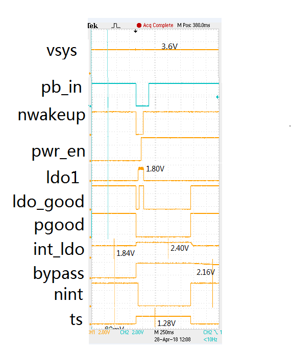

  • Hi Brian,
    Thanks for your help.
    We captured waveform with oscilloscope but since the max timing scale we have is 250ms so we cannot capture with 1s/div.
    -LDO1 start to output 1.8V when PB_IN fall, but return to 0V after PWR_EN assert high.
    -Why LDO_GOOD and PGOOD start and end at high?
  • I am going to ask you the same question: why are PGOOD and LDO_PGOOD high before the PB_IN push button is pressed?
    LDO_PGOOD can be high when only LDO2 is enabled and in regulation at 3.3V, but PGOOD should not be high when LDO1 is low.
    Can you also measure VIO and determine if VIO is applied externally before the Battery is connected?
    This would effectively allow any of the I/Os to go when the PMIC is off and produce this strange behavior.
    It would also pull SYS and BAT up to ~1-2V when no voltage is applied at the BAT pin directly. This is the most obvious way to see that VIO was applied to the PMIC too early.
