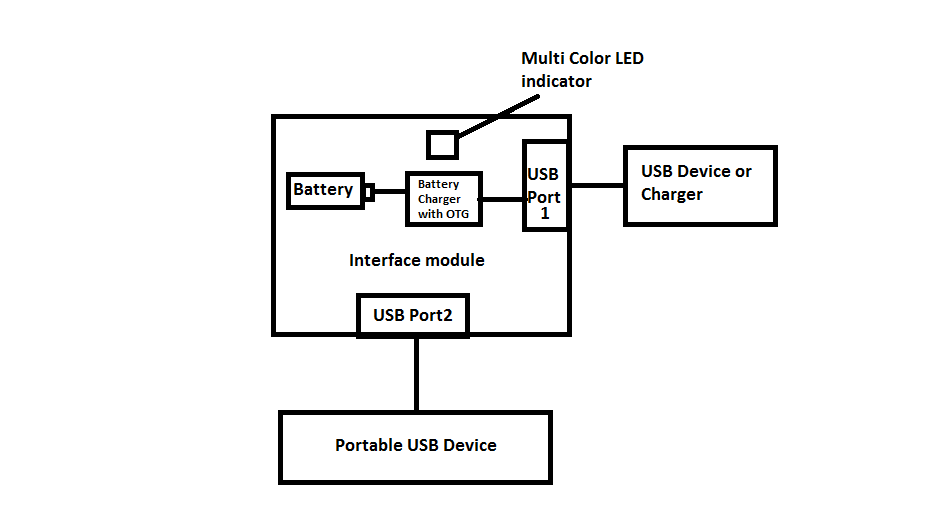

We are developing a medical  device which is the interface between Ultrasound transducer and portable USB device (eg. Mobile, Tablet etc.).  Below are the requirement specification of the interface Module
  1. It is a self-battery powered device with single cell 3.7V li-ion battery
  2. The interface module has got two USB ports (Port1 and Port2).
  3. Port 1 is used for connecting the ultrasound transducer device and charger (for charging in built battery) (USB OTG is required for this port).
  4. There is multicolor LED indication on the module which shows the battery level and charging status as mentioned in the following table.

I have also attached the block diagram for better understanding of the interfaces. Please suggest any charger IC or a fuel gauge IC which can fulfill the above requirements. LED indication control requirement is on priority to meet.
  • Rineet,
    Since the charging input and the OTG output are on the same Port 1 and you want to read the battery voltage information, you can use bq25890. It has integrated ADC to get the battery voltage information. You need to have a host controller to implement the desired LED pattern.
