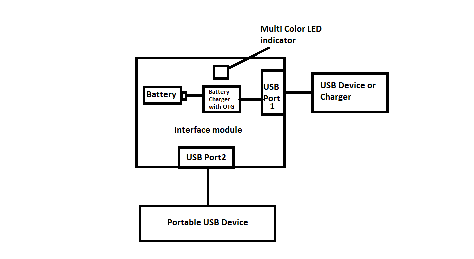

We are developing a medical  device which is the interface between Ultrasound transducer and portable USB device (eg. Mobile, Tablet etc.).  Below are the requirement specification of the interface Module
  1. It is a self-battery powered device with single cell 3.7V li-ion battery
  2. The interface module has got two USB ports (Port1 and Port2).
  3. Port 1 is used for connecting the ultrasound transducer device and charger (for charging in built battery) (USB OTG is required for this port).
  4. There is multicolor LED indication on the module which shows the battery level and charging status as mentioned in the following table.

I have also attached the block diagram for better understanding of the interfaces. Please suggest any charger IC or a fuel gauge IC which can fulfill the above requirements. LED indication control requirement is on priority to meet.
  • For your custom LED color scheme you will need to utilize an MCU such as an MSP430 to control them. The MSP430 could communicate with the fuel gauge via I2C to read the SOC (state of charge) and monitor the charge status and button and then control the LEDs per your scheme. A fuel gauge like bq27546-G1 or bq27426 might suit your needs.
