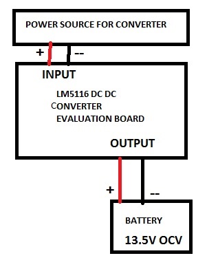

I am testing LM5116 Evaluation Board for its performance and functionality to verify if it satisfies our requirement. The test which I conducted was to connect a battery in parallel with the output of the evaluation board. But there seems to be a drop in the output voltage from required 12V to around 10V when a battery with OCV 13.5V was connected. Kindly provide suggestions to rectify the problem. A demonstrative circuit for the same has been shown below.
  • Hello Ansurhree,
    It is likely that start up into a pre-bias load may be having an issue with Gate Drive supply of the HSF. I would try decreasing Cboot from 1uF to 100nF. 100nF should be more than adequate.
    Hope this helps?
    David.
