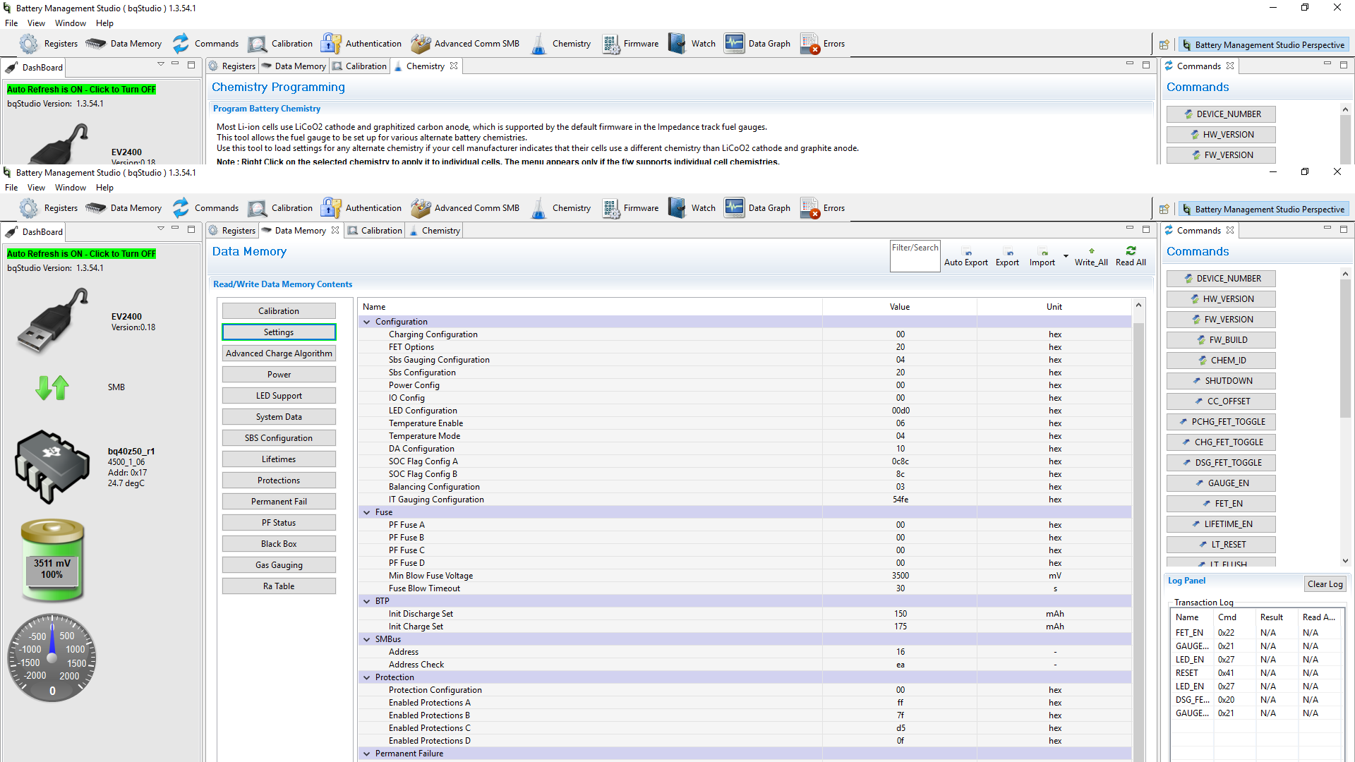

I am currently writing my bachelors thesis and have a couple of problems with the Bq40z50EVM-561. I am using the BQ-Studio, but i can't seem to get it to work.
My setup is as follows:
-I got a voltage source, providing 5V.
-I got the Bq40z50EVM-561 with one LI-ion cell connected from 1N to 1P. the orther ports are connected as they should be.
- all of this is connected to the Pc using the EV2400
I already changed the DA config to "0,0" so it accepts the connection with 1 Cell.
I still cant manage to get to load the cell or create a golden file. I still have a hard time to understand all the steps that are necessary to get it to work.
So far I tried to calibrate and than choose the right chemistry, but what do i got go do next? is there an easy way to set up?
I also got problems to use any commands,  because the device seems to be seald.
Thank you for helping me.
Ps: I added an Image of the dashboard so that you can see my current connection

  •  hey steve,
    thank you for your quick response, i still got an issue though. If I understood the guide correctly than I have to use the command "fet enable" to get through the procedure of creating a golden file. Unfortunately I can't use any commands because I am in the sealed mode. If I try to use the command "Unseal" or "Unseal full acess" it won't work, as you can see in the Log panel in the attached picture.
  • From your screen shot, the gauge is not sealed as your SEC1, SEC0 status is 01, which means Full Access (see page 107 of the bq40z50R2TRM, literature number SLUUBK0A for details).
    Please confirm that you have the EVM set up for a single cell, and that you have shorted together the unused cell connections so the device is powered by the battery.  This is described in the bq40z50EVM user guide (literature number SLUUAV7B) in Figure 2. Without these connections, you will not be able to enable the CHG or DSG FETs.

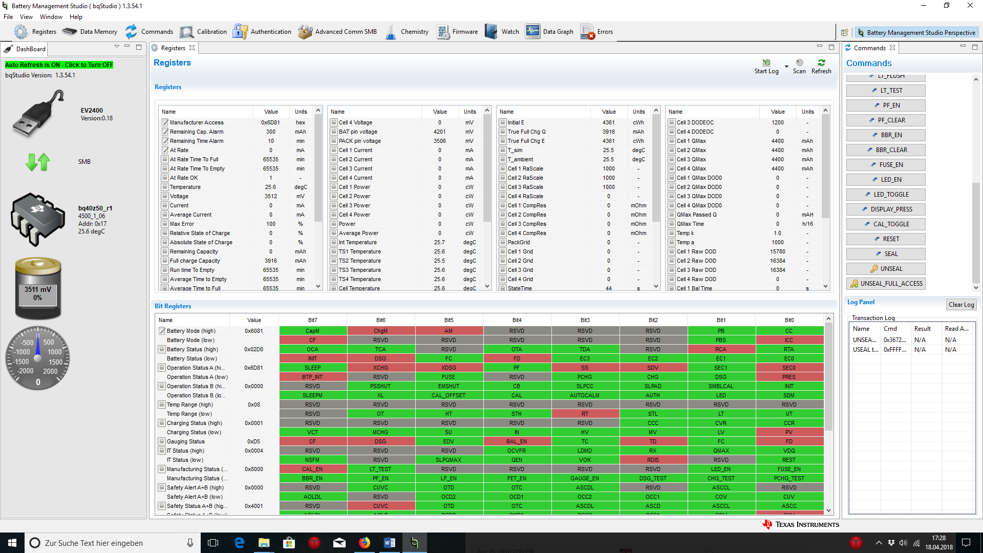

  • hey steve,
    thank you oncen again for your quick response. If I am unsealed, than howcome i still can't use any commands? As you can see in the log, i tried different commands, but none of them is working. Any Idea why?
    I also added pictures of my settings and the successfull calibration
  • From what you sent, I can not tell if you have the EVM configured correctly for a single cell.  On the registers tab create a log file and send it to me so I can inspect the settings and help troubleshoot your set-up.

    I can see from your log file that the EVM and supplies are not set up right, as you have the following:
    CellVolt1 CellVolt2 CellVolt3 CellVolt4 vBAT vPACK
    3513 0 0 0 4200 3512
    3513 0 0 0 4199 3511
    3513 0 0 0 4200 3513
    3512 0 0 0 4201 3511
    3513 0 0 0 4200 3511
    3513 0 0 0 4199
    3512
    Your CellVolt1 voltage and vBAT voltage should be similar, and the vPACK voltage should be your charger voltage from the sourcemeter when the CHG FET is disabled.
    It should look like this:
    CellVolt1 CellVolt2 CellVolt3 CellVolt4 vBAT vPACK CellCurr1
    3968 0 0 0 3997 4224 0
    3969 0 0 0 3999 4224 0
    3968 0 0 0 3999 4222 0
    3969 0 0 0 3997 4224 0
    3969 0 0 0 3998 4224 0
    4024 0 0 0 4054 4084 195
    4026 0 0 0 4057 4080 197
    4027 0 0 0 4058 4080 196
    4028 0 0 0 4059 4082 198
    4028 0 0 0 4060 4082 196
    During this log, I enabled the CHG FET to start charging at 195mA.  The PACK voltage was current limited by the sourcemeter, so the voltage floated to the battery voltage.
    Please check your set-up again.
