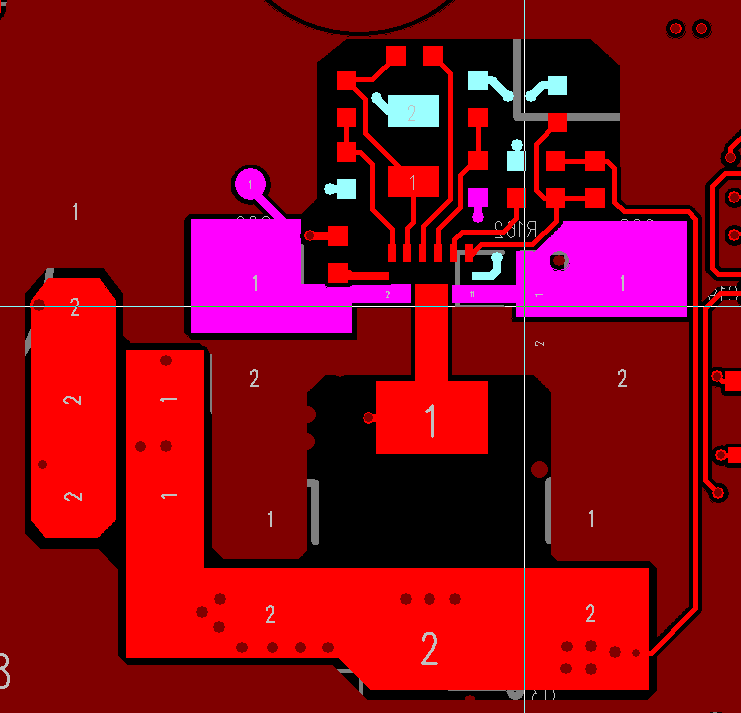

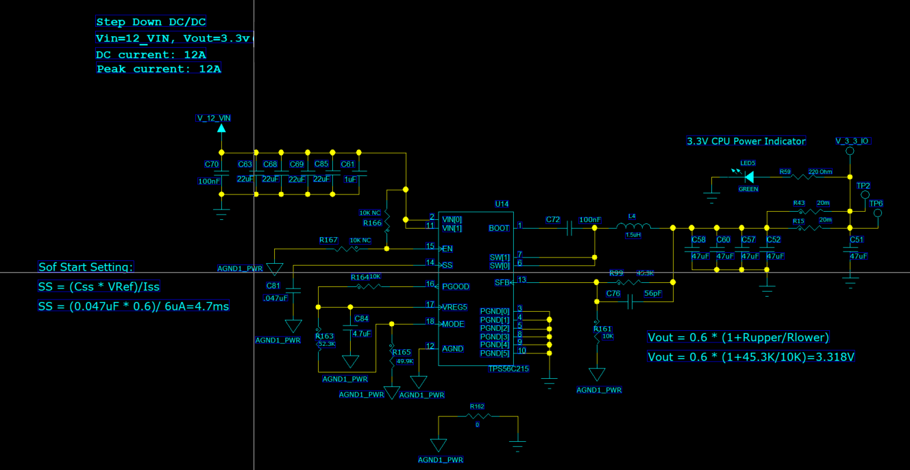

I have questions and concerns using the TPS56C15 on the CPU main board. Looking at the reference design, there are 2 grounds (analog and digital) and combine them at one point. I have it on my CPU board, and with the full system load, the moment we try to change some settings, it resets the board. See below reference.

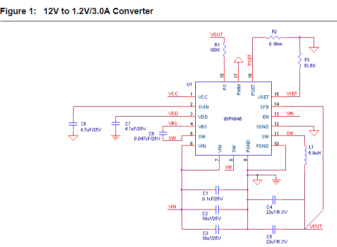

I used marvel supply with no separation of ground, and i never had this issue. See below Marvell, but ignored the 2 grounds, and use it as 1 common ground

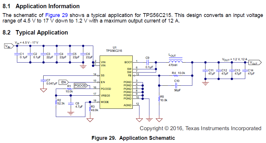

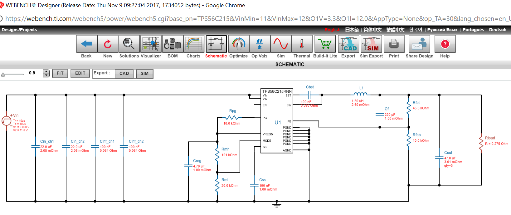

Why are we having this issue if i isolate with 2 grounds,and if i use one common ground, I believe that should able to solve it. From the TI website the workbench showed it as one common ground. see below schematic.

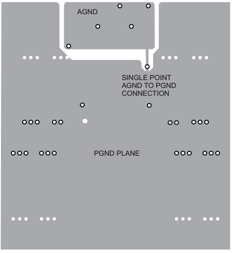

    2 grounds layout is used on high current applications to improve noise immunity. It's just the same with single ground on schematic level since the 2 grounds are eventually connected through one point. So where you choose as the connection point matters. You can find the recommended layout on the datasheet. If possible, please attach your schematic and layout of TPS56C215 part for us to review.

    See below the schematic

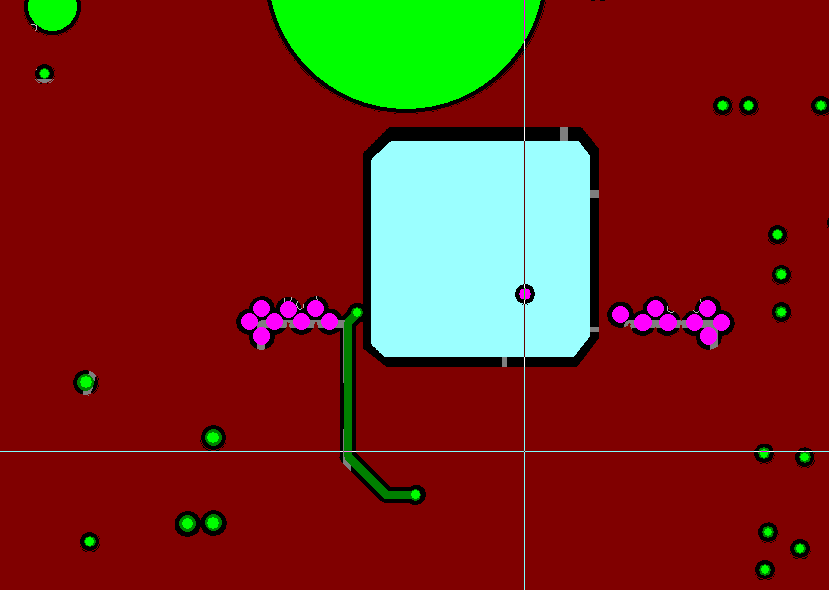

    Top layer

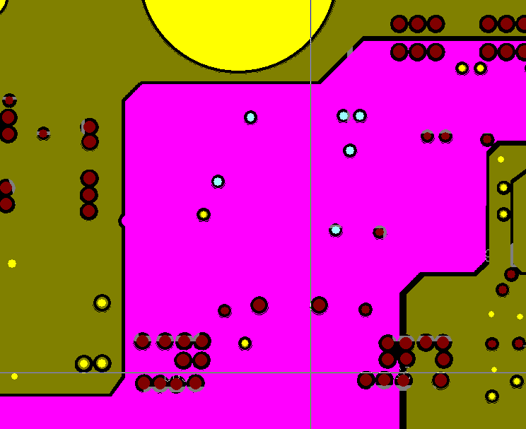

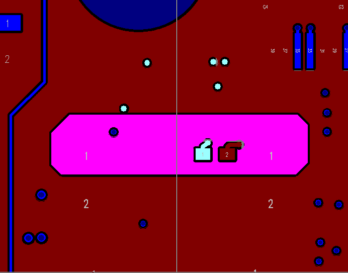

    2nd Ground layer
    Power plane
     Bottom layer (zero ohm resistor you see at the bottom layer to connect analog and digital ground)
  • Hi
    You may not use these vias to connect AGND and PGND, refer to this layout:

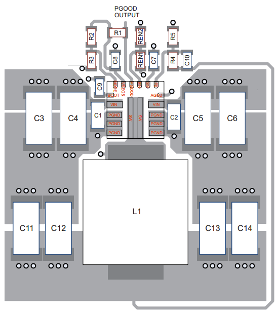

    Where are your input capacitors? You cannot use the long path and vis connecting capacitors to VIN and PGND. They should be put on the main current path.

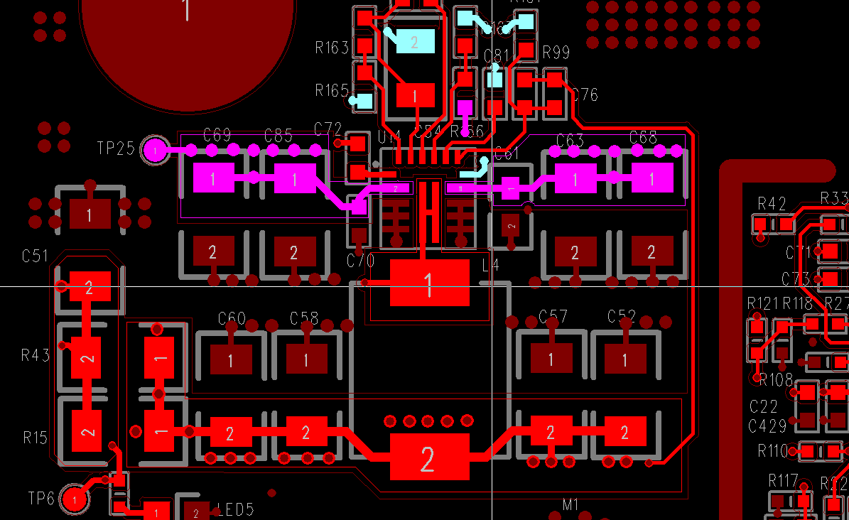

  • Hi Ivan,
    In fact  please see the input capacitors below, input capacitors are very close to the input pins on both sides. I am not using a long path, i am exactly following the layout recommendations.
    On high current applications, path is nothing but inductors. If the AGND pads is far away from input Cap GND pads which are considered as constant GND, current transient will coupled voltage peaks on AGND and cause errors on IC setup pins. Using one common GND, every AGND pad has a different path to Cap GND, causes the issue worse. So it's better to separate AGND and PGND and your problem will not be solved using single GND.

    Actually the voltages of different point on PGND plane are different when switching due to the impedance and current. If use one common plane, different AGNDs locate on different points of PGND and the AGND references would not guaranteed to be the same. The power current is hard to depict, so I believe using 2 GND planes and finding a single point are safer.

    Besides, I still have doubts on the connection with AGND and PGND, since the path is long, lies above Vin plane, and Vin noise will have the influence on AGND. You can have the try removing the 0Ohm res and connect AGND and PGND with a very short wire just on the first layer. The wire should be kept away from switching node.
