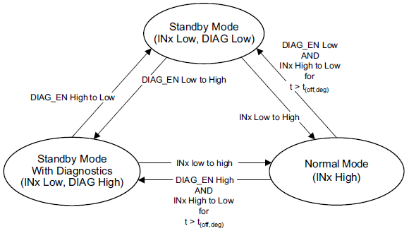

Hi team
I have three question about diagnosis
#1
Can perform diagnosis at working?
According to the following figure diagnosis can only occur in waiting mode
If overloaded, must INx be set to Low be implemented diagnose?
#2
How does this device work If overloaded?
(keep INx High)
#3
We try Open load, FAULT does not output Low
What settings are we missing?
Thanks in advance for the help,
Best regards
    1- The diagram in figure 37 shows the states normal and standby. It shows also diagnostic in standby mode. Diagnostic is active when DIAG_EN is high. There is no diagnostic if DIAG_EN is low. Diagnostic in overload condition both DIAG_EN and IN should be high. If IN is low the FET is off and load current is 0A. Please check table 1 and 2 in page 19.
    2-   Please check table 1 and 2 in page 19.
    3- In open load if IN is high the output is high. If IN is low the output needs pull up resistor to keep it high for open load diagnostic
