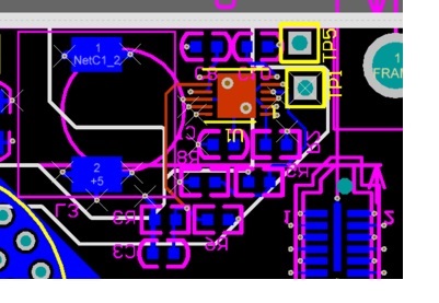

  • Hi
    Its about 0.08 to 0.1 ohms, its a 100uf 10v X5R cap in a 1210 package.
    The layout is attached here, its in an area about 0.75 inches by 0.3 inches, its pretty compact on a 6-layer board. The SW pins are into planes and all +28v input are on full planes with full ground planes.
    One thing, in checking all of the part#s, I noticed we are using the LM5160 and not the LM5160A.
    That shouldn't matter? Is there some difference between the 5160 and 5160A (besides the VCC pin allowing external drive) that we should know?
  • Hello Steven,
    I am assuming pin 1 (Gnd) is in the bottom Right hand side of the device in the layout pic you posted?
    Unfortunately it appears that the layout guidelines have not been followed? The layout guidelines are presented in the datasheet on page 27.   The biggest issue I see is you do not have Cin close to the device.  I did not see an input cap on the schematic you posted either?  this need to be next to the pins Vin and Gnd...
    It should be noted that CVCC, Cboot and feedback network all need to be placed close to the device.
    I believe your issue is directly related to the layout?
    Hope this helps?
    David.
  • i don't know about that. the input cap is a little further away, so that isn't actually right next to the part. we are going to add one right next to it at the two test points. However, I can't believe the part would explode in 5 seconds with no load. I am going to add another 2.2uf closer to the component - which is easy to do.
    Again though, the part turned on - regulated to +5v volts for several seconds and then it fails. So it acheived steady state, got beyond the ramp up to power the COUT, and then self destructed. This makes zero sense
  • And all of the other parts are within 0.200" inches of the LM5610. You can't really get much closer than that. Even on the reference design, they are about 0.100 to 0.150 away. The parts take up space. If the feedback network was 6 inches away with 3 mill traces...sure that would oscillator. 1/10th of an inch away on a 6-layer board, with no load ... and seeing the part regulate to +5v... something else isn't right?
  • Hello Steven,
    I am sorry, I don't mean to labor the points here...but I believe the following needs to be addressed in addition to Cin.
    1. C1 need to be close to the pins
    See datasheet suggestion below.
    "CVCC and CBST: The VCC and bootstrap (BST) bypass capacitors supply switching currents to the high and
    low-side gate drivers. These two capacitors must also be placed as close to the IC as possible, and the
    connecting trace length and loop area must be minimized (see Figure 36)."
    2. Feedback network is far from the feedback node
    "The feedback trace carries the output voltage information and a small ripple component that is necessary for
    proper operation of both the LM5160 and the LM5160A. Therefore, take care while routing the feedback trace
    to avoid coupling any noise into this pin. In particular, the feedback trace must be short and not run close to magnetic components, or parallel to any other switching trace."
    Hope this helps?
    David.
  • Well see... I think the issue is related to inductor and spikes somehow. Interestingly, I can't get webbench to recommend 27uh.. Only 47uh now. I have new parts and inductors coming tomorrow. We will figure out the issue here.
  • Ok - its fixed now. So you were on the right track with the Cin capacitance. Even though ours is about 0.350" inches away from the LM5610, it should have worked. BUT! The pcb was built with a 0.01uF cap and not the 2.2uF bulk input caps. So the board really didn't have any CIN at all, just 0.02uF. The inductance of the leads from the power supply, combined with the incorrect CIN was causing a huge ground bounce. When the inductor started up, the SW would see about -15V on it due to ground bouncing and it would cook the chip. Replacing the 0.01uf with the 2.2uF, its working just fine now.
    What a hassle. Thanks for forum replies
