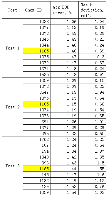

I found there is chemical ID 0245 for Spring Power 355065 Cell, but when I used ID 0245 for this cell to do learning cycle, update of Ra table was always disabled during discharge (C/5 discharge), Operation Status register R_DIS bit set. I tried for three times, Ra table update was always disabled, Operation Status register R_DIS bit was always set during discharge. However, Qmax can be updated after discharging to term voltage and relax for 5 hours. I blieve that ID 0245 can't be used for Spring Power 355065 Cell.
Then I followed GPC guide to charge and discharge for single cell and upload data to websites to select chemical ID. I tested three times for three cells data and got three chemical ID report. But the best ID listed in these three report is different, and there is no ID 0245.
Can you advise which Chemical ID can be used for Spring Power 355065 Cell? I have tried ID 1185, but Qmax did not updated after charging to taper current and relax for 5 hours, besides the FCC is much lower than cell normal capacity.
You can see the first ten ID of these three selection as below, for more detailed please refer to attached .zip file.
