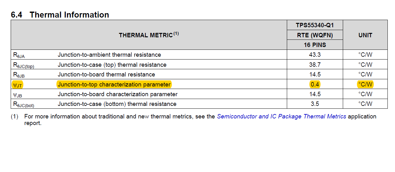

I am working on a design with TPS55340. I am wondering what is the best way to measure the IC junction temperature to ensure that I am staying within the 150C spec of the device. I understand the measurement should be taken at normal operation, but I am curious to know if there are any recommended instruments or methodologies for this measurement.
For the sake of context, my normal conditions are 6-10Vin, 26Vout, ~700mA out.

  • Different layout will have different thermal perfomance.  so layout is a key point for the thermal. So firstly, please refer to the TPS55340 EVM and datasheet for the pcb layout.
    Suggest you use a 4-layer board to get  good thermal performance.
    The best way to measure thermal is using juncttion-to-top characteristic.  So you need to test the thermal on the TPS55340's top, Tj=Ttop+0.4*Ploss. For the TPS55340 Ttop and the Tj is very close if the loss is not big. Ttop is determined by the layout.
