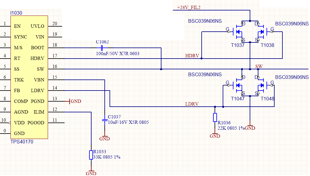

I am going to design DC-DC convertor with input range Uin = 15-30V and output voltage Uout = 3,3V/35A. And I would like to use TPS40170 with transistor BSC039N06NS. I would like to use two transistor for HDRV and LDRV switching for better thermal performance (see. schematic.png).
Is the TPS40170 suitable for drive this transistor in dual mode or not?

    Yes you can use the FETs as shown, I recommend using the LM5145 as an alternative to the TPS40170 as it is is a new part released last year.
    Hope this helps?
    David.

    I don't think there will be issues with either in this regards. EMI should be mitigated with the following considerations.
    1. a Layout in strict accordance with the guidelines stipulated n the datasheet.
    2. Place holders for Top side Gate resistor to slow down transition times of the Top FET.
    3. Place RC snubber from Vsw to Gnd
    4. Placeholder for CM/DM filtering at the input side of the power stage.
    5. Use a shielded inductor
    Hope this helps?
