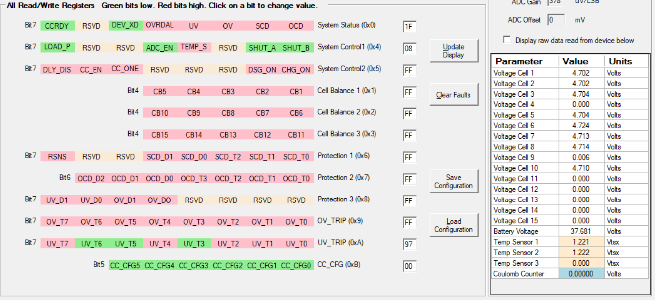

I have been working with the BQ76930 EVM for a few days and I currently am frequently experiencing an issue when the module is scanning. After following the setup instructions to connect the module to my computer I begin scanning with the bq769X0 Evaluation Software and usually within about 10 seconds the GUI stops receiving new data from the module. This usually requires a hard reset of the board and the GUI in order to begin receiving data from the EVM again. Has anyone else experienced this issue and/or are there any tips to fix it?

    Thank you for the recommendations. I am currently not using the gauge, and I have removed all 4 gauge shunts. Can the gauge still shut down the module if I do not have the gauge shunts connected? Based on your description of what would happen if the gauge was connected, that seems to closely align with the problem I am seeing where I can read the cell voltages only a few times before the voltages stop changing on the GUI.
    Based on your other advice, I have not yet removed the resistors as recommended by section 6.4, but I have shorted C3 to C4 and C8 to C9 (giving me an 8-cell based configuration). After doing this, I still seem to be having the issue when applying 38V.
    I also noticed that once this issue has occurred, the GUI sometimes has the System Control 1 register momentarily flash 00, then FF, and then almost all of the registers turn red. Could that be happening if the BQ76930 is off? See the image below for most of the registers turning red.
    This all happens very quickly, in <1s. I am not sure why this  is occurring?

  • After some more testing, I believe I understand why the voltages stop changing --
    Upon some observation, while running the byte 0x04 (System Control 1) is originally 10 and then without any user input changes to 08 or 0C [(0001 0000) ADC is on] to [(0000 1xxx) ADC is off]. This appears to only occur when I have checked the "Scan" button (for scanning automatically). I was able to manually "Update Display" about 50 times and had no issues.
    I have not yet seen anything in the documentation to indicate that this is a normal function. Has anyone else reported the issue?

    Reading all FF for registers is common if there is a broken data line, but it usually happens after the slave nacks the address. There should be a status message in the bottom of the window or a popup window if the device nacks. It is hard to envision how a series of reads from the device by scan would cause a write of 0x08 to register 0x04.
