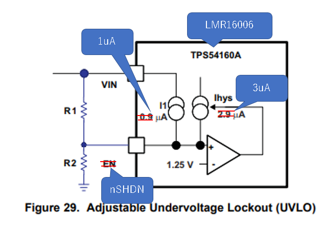

Could you let me know internal circuit of nSHDN pin, please?
I think the circuit is below.
Is it correct?
This circuit is showed at datasheet of TPS54160.
Does LMR16006 have same circuit as TPS54160?
