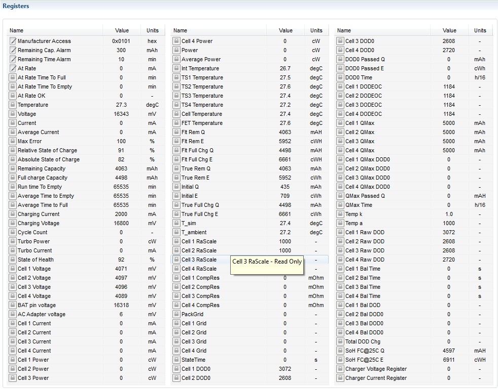

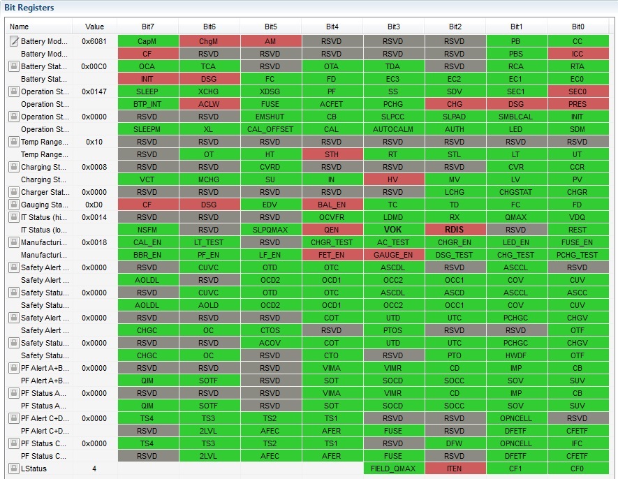

I can not successfully finish the learning cycle. I use 4s 5000mAh lithium battery pack and EVB. All alarm bits are cleared. But the update status does not change to 05 after the rest period.
Could you check my settings file?
I use a BQ40Z60 without a charger function. The connection of the branded charger and the load is carried out through terminals VSYS and PGND. Is this correct?
In addition, after the end of the charge and the rest period, the RSOC drops to 92%. Is this normal?
