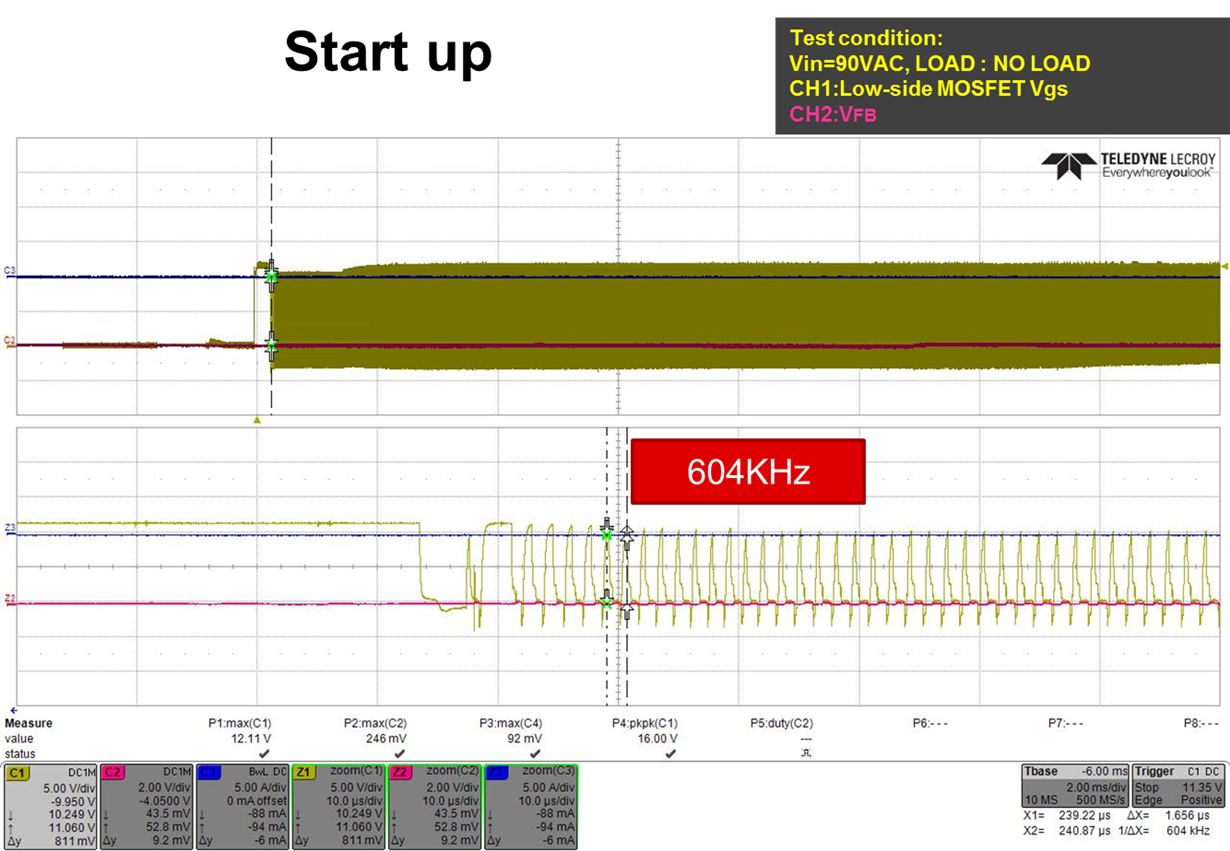

hi
During soft start operation, the frequency is displayed up to 600k.
The datasheet states that it is up to 1M.
Is it normal to look at the datasheet data above?
  • Hi, Andy
    1MHz is the maximum switching frequency capability of UCC256304. The actual switching frequency in soft start is defined by voltage of LL/SS pin and voltage of Vcr pin, 600kHz is pretty normal switching frequency.
    regards,
    Yunsheng
