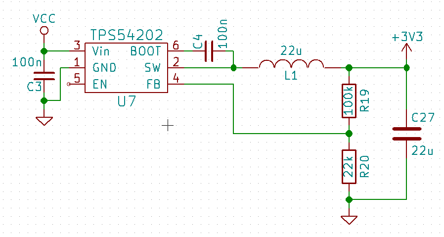

TPS54202: 4x higher quiescent current compared to datasheet
Part Number: TPS54202
Other Parts Discussed in Thread: TPS62177

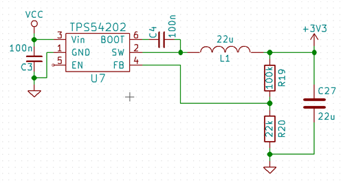

I have used a TPS54202 in a design with a low power microcontroller which needs to go in low power shutdown (<100uA) to preserve battery life. However, I have build up the PCB with only the DCDC circuit and measured the 3V3 like expected but the input current without any load is ~180uA. This is 4 times the quiescent current specified in the datasheet (45uA). What can be causing this? Do I need a different converter?
