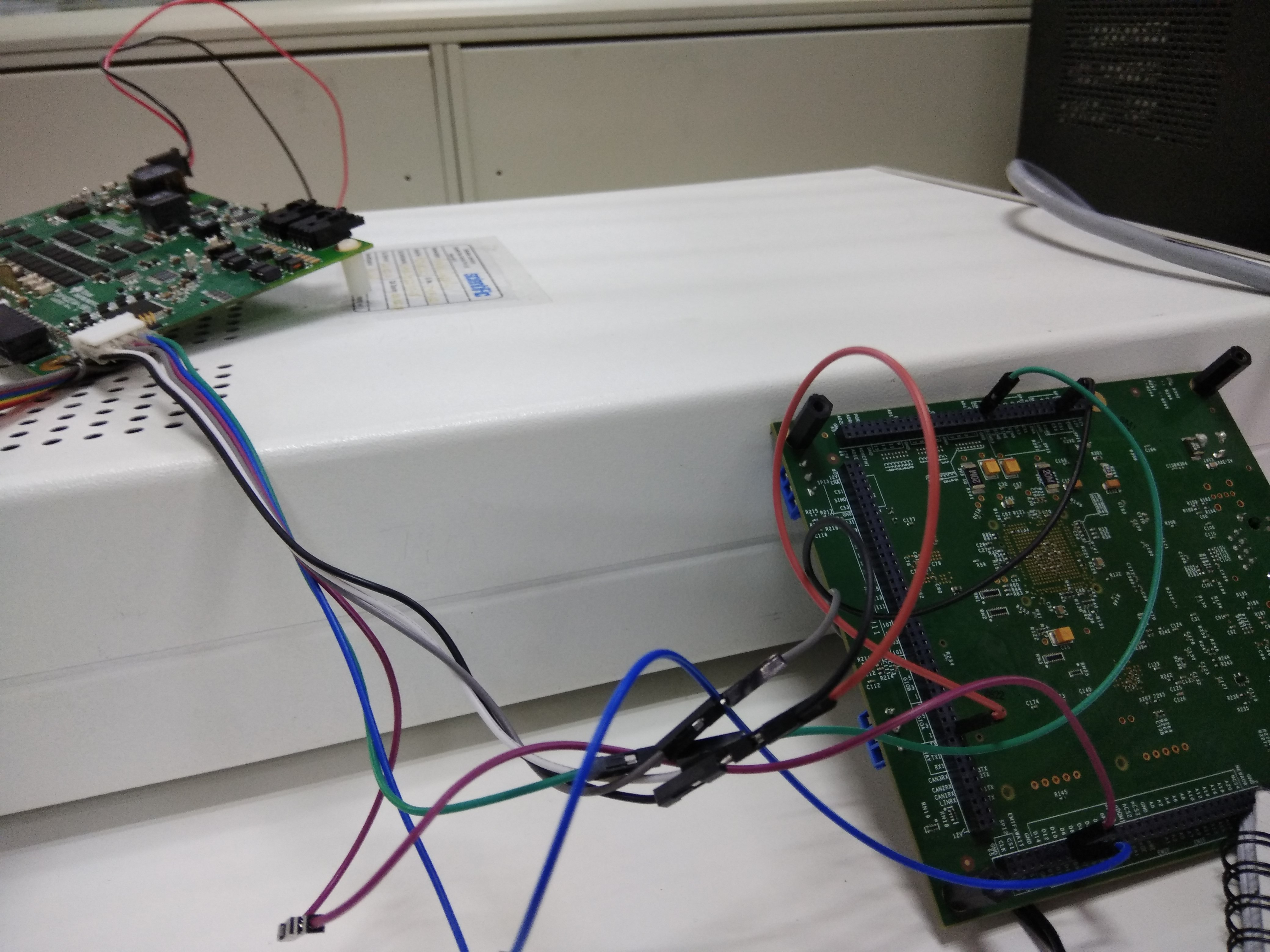

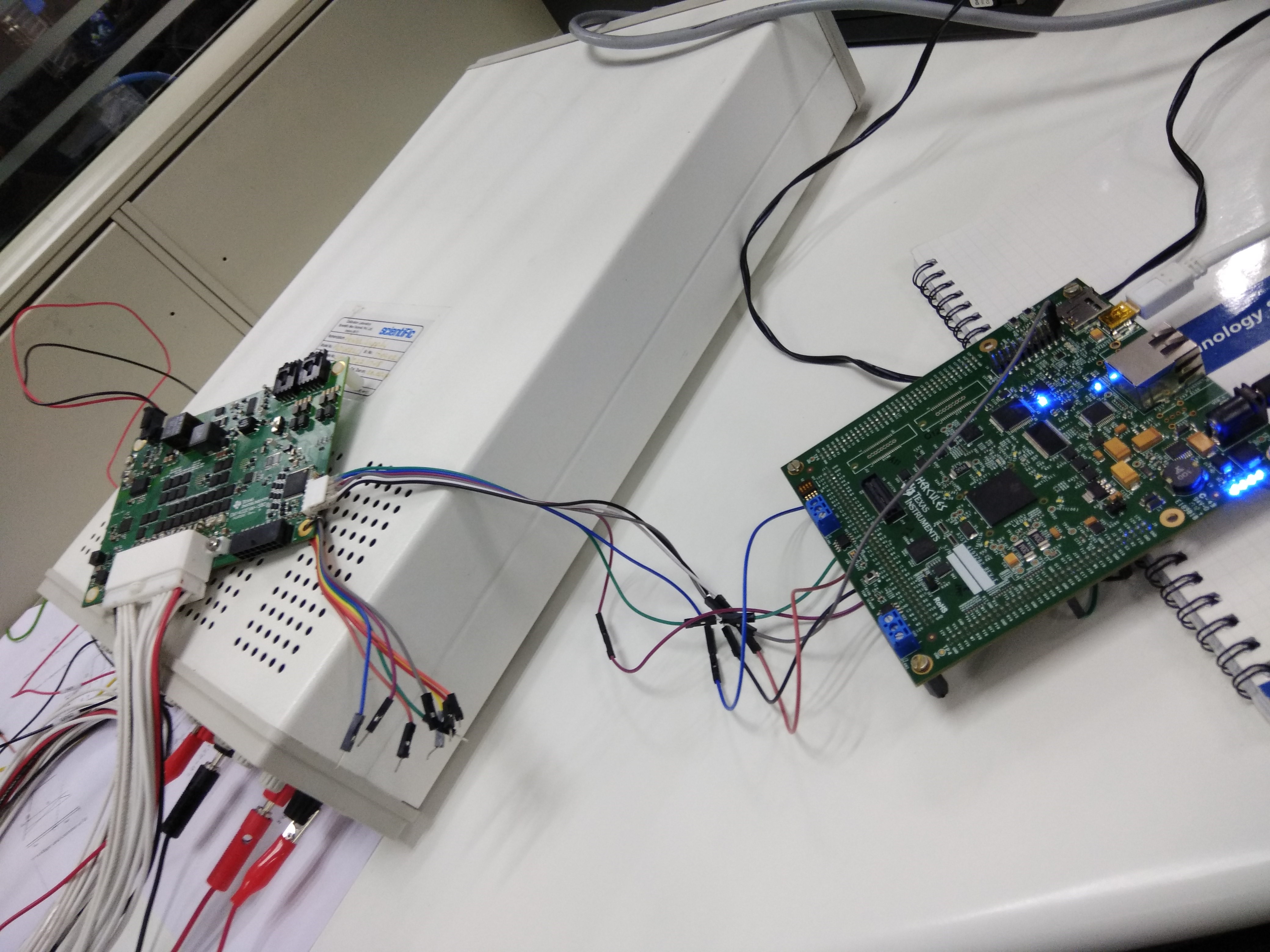

We have few question regarding active cell balancing. We connected batteries of EM1402EVM board to the power supply with the help of RC circuit and for this, battery gui is working and we are able to see cell voltages in gui. Now, the problem is when we connect UART communication ports of EM1402EVM board to the TMS570LS3137 MCU, battery gui is not opening. So, can you please guide us on this issue.
