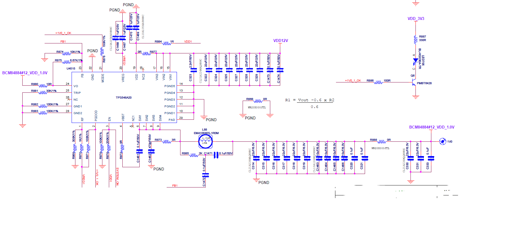

I made a circuit diagram as shown below.
Please review.

The schematic looks good. It seems you have copied a lot of it from the existing datasheet. On thing I can mention, you could use a lower value inductor if you desire. 470 nH or 330 nH would work.
