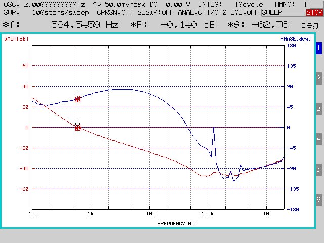

Hello all,
I replaced R16 to 1kOhm in order to make the output voltage to 5V. Changing the output voltage, the phase/gain margin may change, so I measured those margin by FRA by putting 50Ohm resistor on R8. The result is like the below:
I would like to make the response faster. How can I change the frequency of poles and/or zeros, and add poles and zeros? I think R17, C19, R12, C15, R10, C16 might be related to this. Can you share your ideas?
RYO
