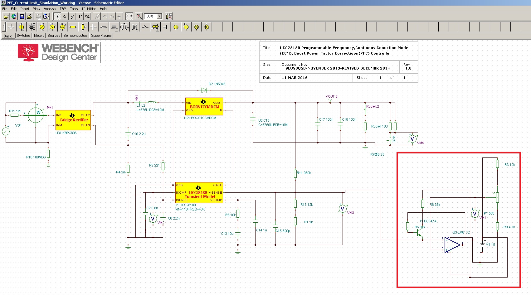

I am looking to implement a current limiting circuit externally where the I disable the PFC by shorting the Vsense when the current is higher than a set limit causing the output voltage to drop and enables once the current reduces below a threshold.
I am looking for some input into any circuits which have been used previously to perform this function. Alternatively, your opinions on whether or not this is a feasible solution would be very helpful.

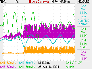

In the image below CH4 is the output signal of the amplifier, CH2: is the PFC input current, CH3 is the resonant converter current. At present I am using the current limiter on the resonant converter, but it doesnt seem to be the best solution as it affects continuous power operation.

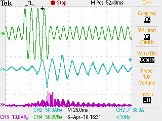

Without current limiting of the resonant converter the input current looks as below.

  • Hi Peter,
    I managed to find a workable solution to my problem.
    The method involves measuring the Vsense voltage and clamping it to a set Vsense voltage during heavy loading on the falling edge. Please see image below.
    This tricks the controller into thinking that the voltage  at Vsense has not dropped below a programmed reference voltage as it flat lines whereas in reality, the output voltage continues to sag, which is acceptable for the application. The current demand during the dynamic loading conditions is thus limited.
    The closer the programmed reference voltage is to 5V target , the tighter the limit to the input current. The reference voltage is set low enough so as not not current limit during continous 3.5kW  operation and only comes into effect when loading dynamically.
    Thank you for your input so far. The outcomes of various current limiting methods finally led to this solution, which means that the current waveform is able to maintain its sinusoidal profile when limiting instead off chopping off the PWM operation.
