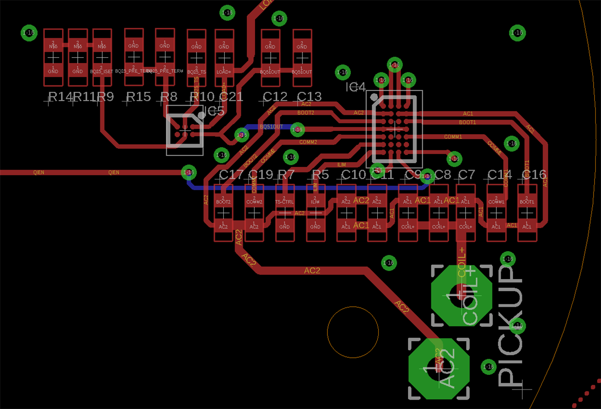

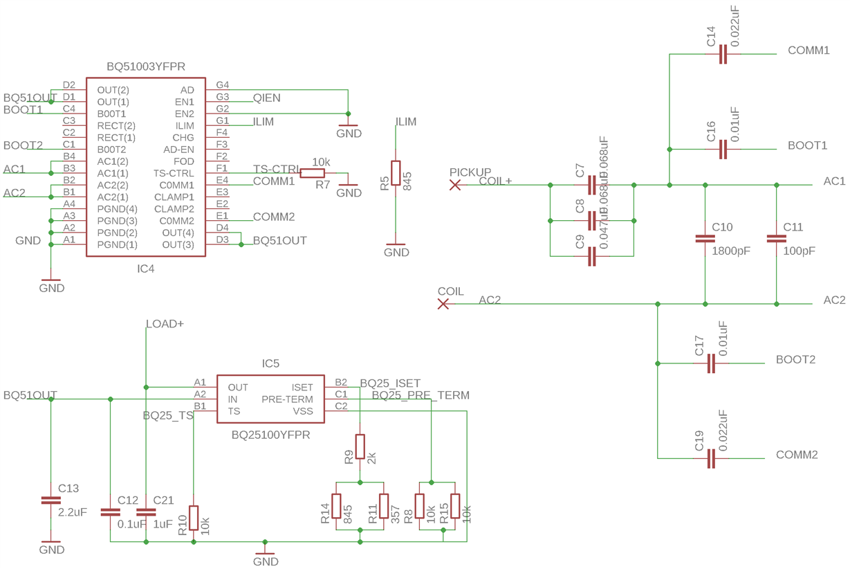

I have used the TIDA-00318 reference design for a wireless battery charger. Unfortunately on my custom PCBs the design is not working, output from the BQ51003 is between 0.5v and 1v.
After rechecking my design I have realised I haven't connected the two RECT pins to each other, would this alone be enough to cause my issues?
Kind Regards
