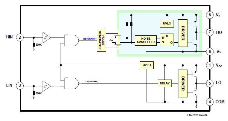

How possible is it that UCC HO/LO Totem poles reversed design require inverted PWM on HI/LI?

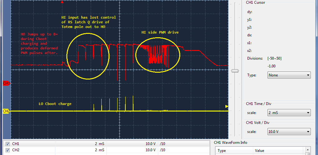

We used same application firmware with top gate driver over past years and not had such PWM issues as with UCC. We can not get UCC B phase PWM to transition onto either side or back to phase A or C phase.  The B phase LI seems to disrupt HS/HB discharge of Cboot path and drive inverter voltage very high above DC supply stopped  by MCU over voltage faults.
Notice the HO/LO PFET is reversed on other vendors gate driver!

    That really doesn't answer my question of why both Totem poles FETS are reversed from other vendors driver or if the HI/LI expect inverted PWM signals in that aspect?
    It seems the LO output is not always producing pulses that the HO output (CH2) always indicates a presence of a falling edge input to LI. Setting scope to capture the LO Ton rising pulses is very random to capture them on CH2 making it seem as if HI/LI inputs are reversed yet they are not. And it still does not answer how Cboot discharge cycle is somehow being compromised by LO. There is no slope in the Cboot discharge on HS output. Perhaps this IC is simply defective then if inverted PWM was not expected on HI/LI.

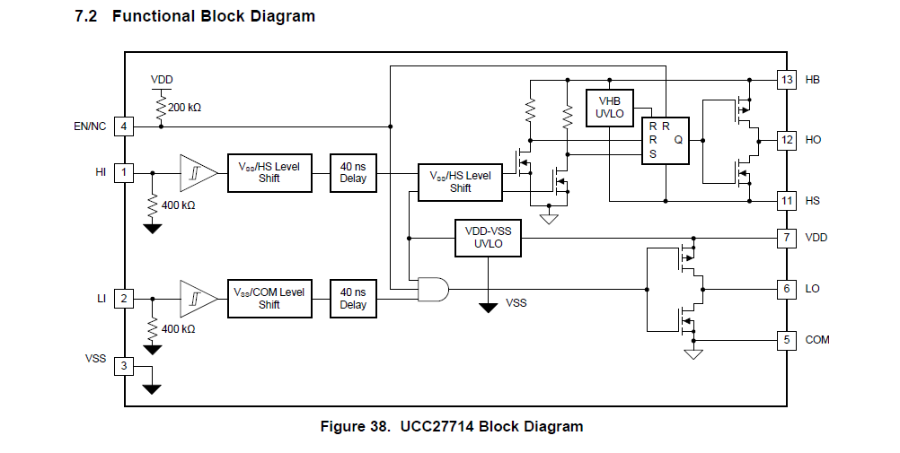

    Figure 38 would be more believable if drawn (Q') driving both Totem poles so HI/LI did not require inverted PWM drive signals?

  • It would seem the UCC27714 gate driver requires complementary input signals HI/LI to function properly. No where in UCC27714 datasheet has any such fact been elaborated or expressed or otherwise noted by figures of signal diagrams. Fact is timing diagram Figure 1/39 both appear to express typical PWM generated signals MCU are capable to produce, nothing about complementary drive signals here.

    The logic inputs are shown in Table 3 of the data sheet.  The only limitations are UVLO which may get tripped if the bootstrap gets discharged, or if the ENable is low. I wonder if the issue isn't UVLO getting tripped?
  • Seemingly the evidence points to table 3 being complete nonsense if the HI/LI inputs are not kept complementary at any point of PWM operation.
    How else could Q be losing control of HO to the point any PWM pulse width sent to HI/LI during Cboot charging >2us causes MCU POR events. Or any PWM pulse width that exceed 2us driving Cboot charging the DC voltage at times peaks over 90vdc from 24vdc  supply. Often LI pulses can not be captured by scope yet cause HS to drop a pulse on HO apparently via high side NFET drain B+ rail.
    Something is seriously wrong with these three gate drivers, produce same sick wave forms in capture. Suspect for one Cboot is not fully charged and the pulse width is set very low to avoid MCU POR events. The UCC27714 seemingly can not handle copartner half bridging where only one of either part of the half bridge (HI/LI) receives a PWM drive signal as the other input remains low. Let alone claiming best in class when HI/LI has been restricted to >100 pulses may have a lot to do with HO jumping to B+ rail in below capture.

    Normally, you would only want one switch on at a time to prevent shoot-thru the bridge. But, we don't have any protection in this IC, so if you command both HI and LI high, both HO and LO should go high.
    I doubt this is the issue, but worth mentioning. Please read section 8.2.2.9 LO and HO Overshoot and Undershoot of the d/s. This can cause erratic triggering on the UCC27714.

  • BTW: I was wrong about the pulses on left side of capture CH1 being Cboot charge pules. They are actually a few cycles of a single code fired after 5ms Cboot pulses far left. So that single code occurring after Cboot drives HO to B+ as if Cboot is lost or being charged when HO then attempts to drive the NFET when it should not. And LO is driving pulse CH2 which made me think it was a Cboot charge cycle but that is the sign wave shape far left
    It almost appears the UCC is self priming Cboot charge from LO side NFET body diode and does not require charging.
