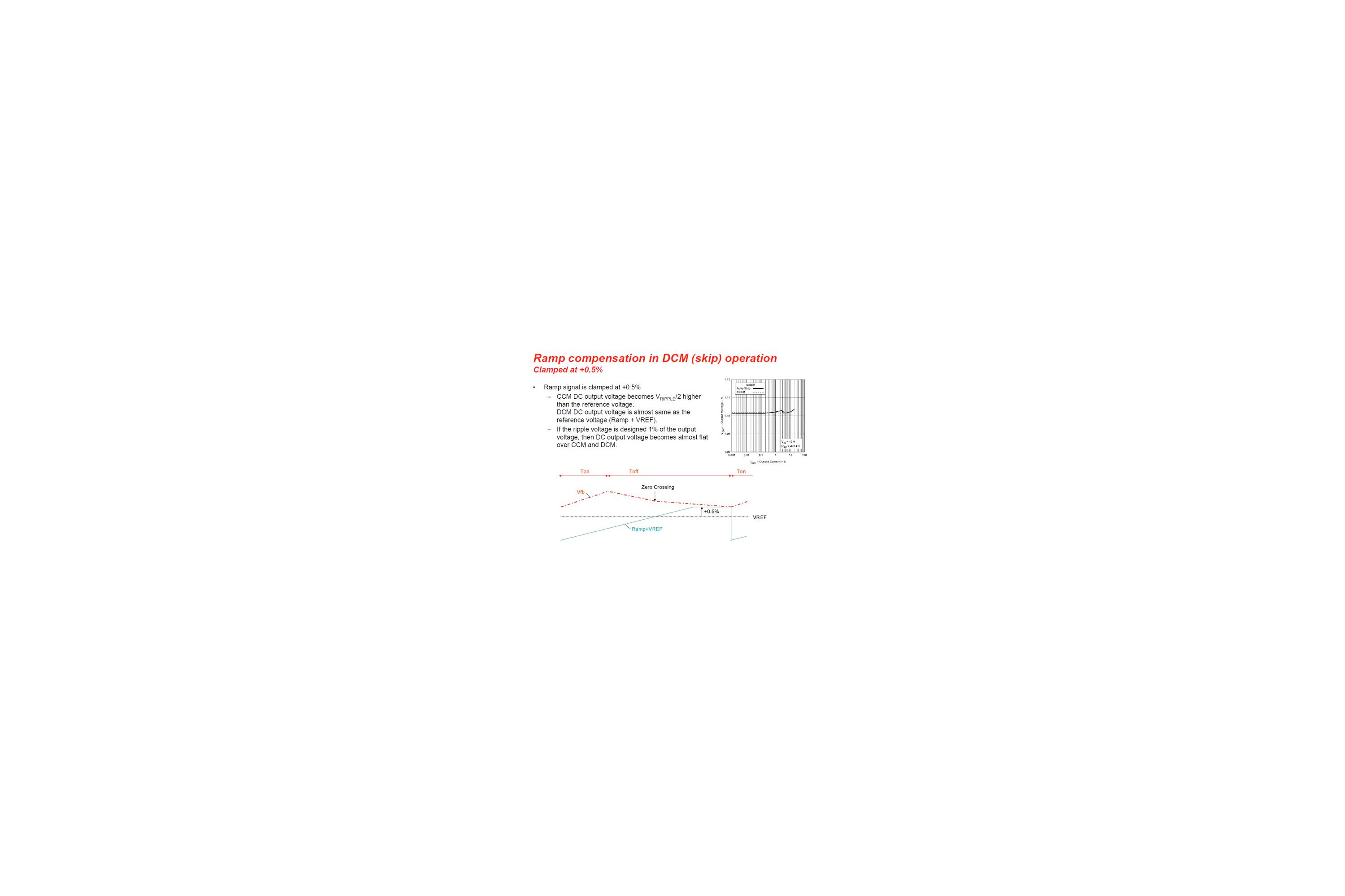

Our customer measure the VFB voltage and the value is about 0.62-0.63V. But the typical is 0.6V. Could you give some comment about it?
Xiao,
Please see the attached pictures for light load and no load condition. Please see the explanation below including picture as to why in D-CAP the VOUT accuracy is off in DCM.
· VOUT average is above VREF by half ripple. So, VOUT average is higher with light load (DCM) and lower with heavy load (CCM).
· During skip mode operation, under discontinuous conduction mode (DCM), the switching frequency is lower than the nominal frequency and the off-time is longer than the off-time in CCM. Because of the longer off-time, the ramp signal extends after crossing 0 mV. However, it is clamped at 3 mV to minimize the DC offset.
