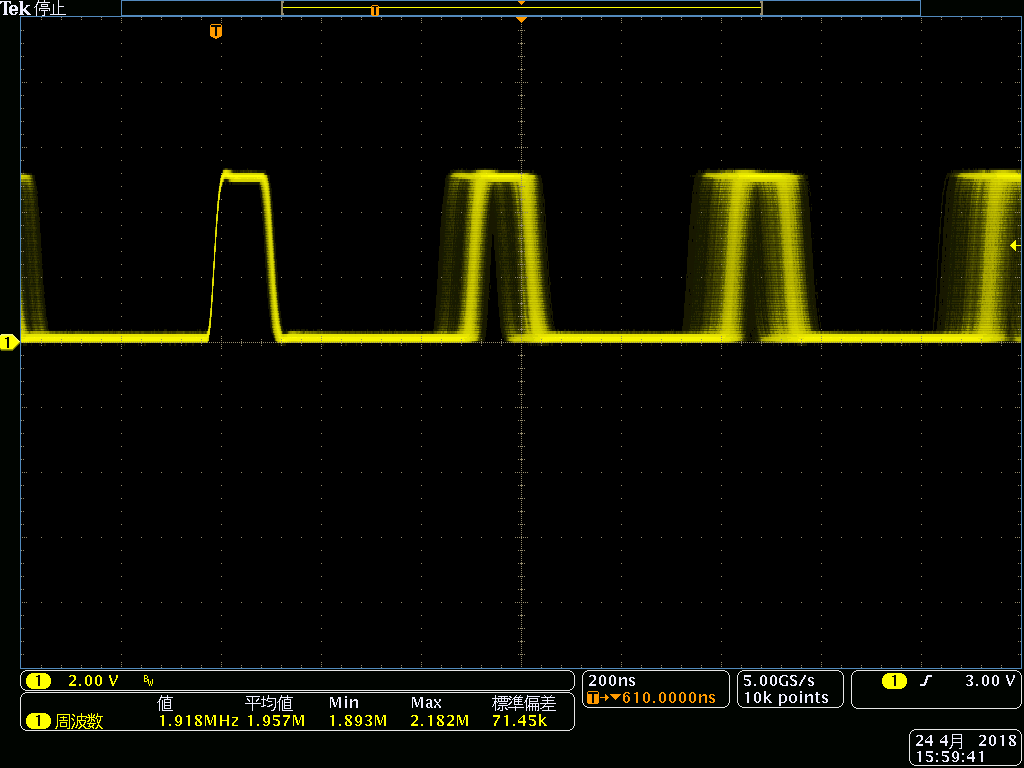

I measured switching frequency on DCDC1 ,2 and 3 of TPS65218 by using osciloscope.
It wasn't stable. These frequency were 2MHz +/- 0.2MHz. It's look like jitter or spred spectrum.
Is it correct behavior? DCDC1,2 and were Forced PWM setting. But DCDC4 is stable frequency.
If correct behavior, Why is it? Can I disable it?

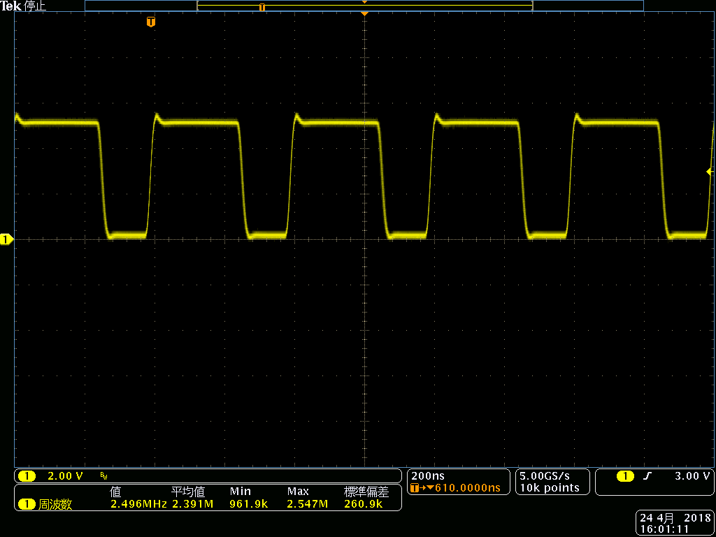

    I attachied it.  1st is the DCDC4.Switching frequency is stable.
    2nd is the DCDC1. It's unstable. Typical frequency is 1.957MHz. Minimum frequency is 1.893MHz. Maxmum frequency is 2.182Mhz.
    It's Forced PWM mode. Please tell me reason.

  • Iwasaki-san,
    I repeated your tests and the first thing I would like to point out is that this is not the correct use of the term "unstable". The DC-DC converter is not unstable and this cannot be determined from measuring the switching node. The output of the DC-DC converters should be stable even if the clock frequency is not very precise.
    Only the switching frequency of DCDC4 is specified in the datasheet:
    The nominal value is specified as 2.4MHz, and it is not very precise (+/-12% = +/-288kHz) across temperature. At room temp, it is reasonable that the accuracy would be a little tighter and within this range.
    You measured 2.182MHz as a max and 1.893MHz as a min value on DCDC1, and even with these measurements this is +9% from a typical value of 2MHz. But the switching frequency of DCDC1-DCDC3 is not specified in the datasheet.

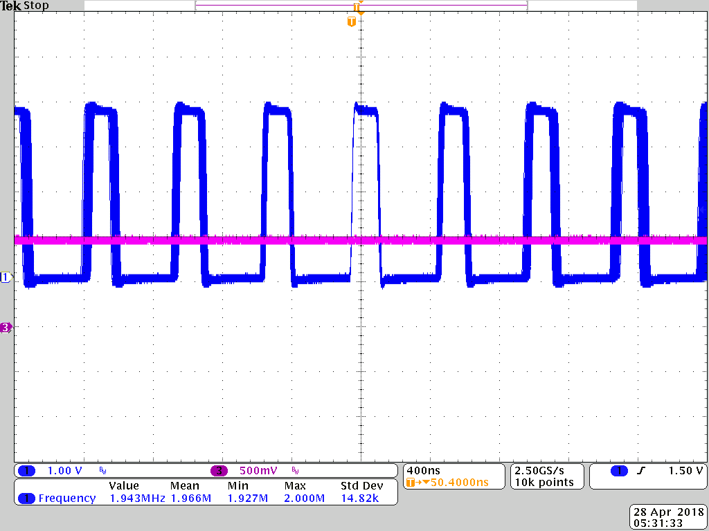

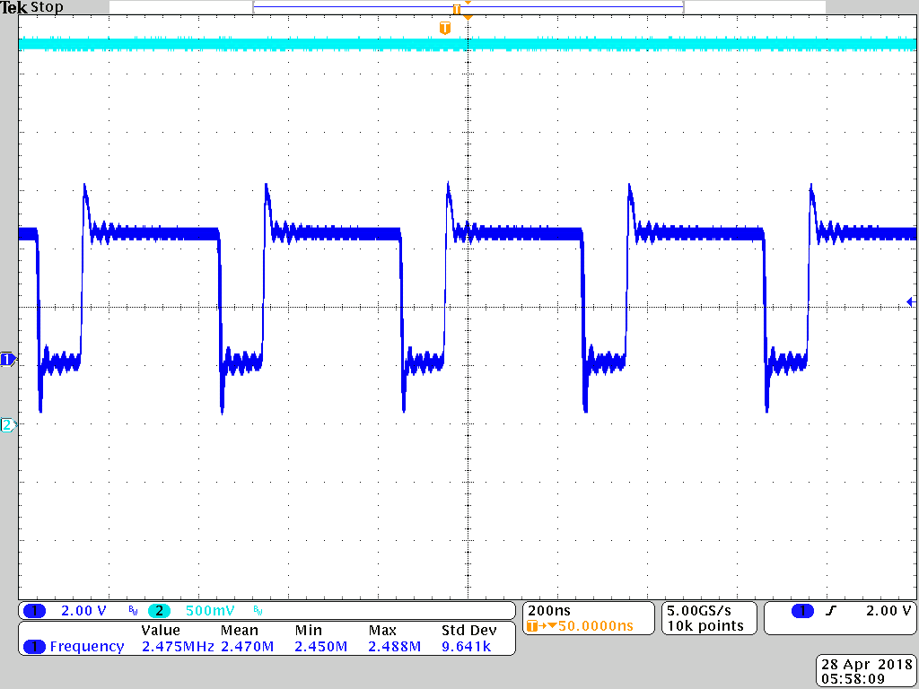

    DCDC4 operating as a Buck with VSYS=4.3V with switching node on Channel 1 and DC output on Channel 2 (3.3V):
    DCDC4 operating as a Boost will result in different switching frequencies (not shown here as this question is about DCDC1). The ripple of DCDC4 is also not relevant to this discussion, as this EVM has less capacitance on the output of DCDC4 than recommended.
    DCDC1 with VSYS=3.6V on Channel 1 and DC output on Channel 3 (1.1V):
