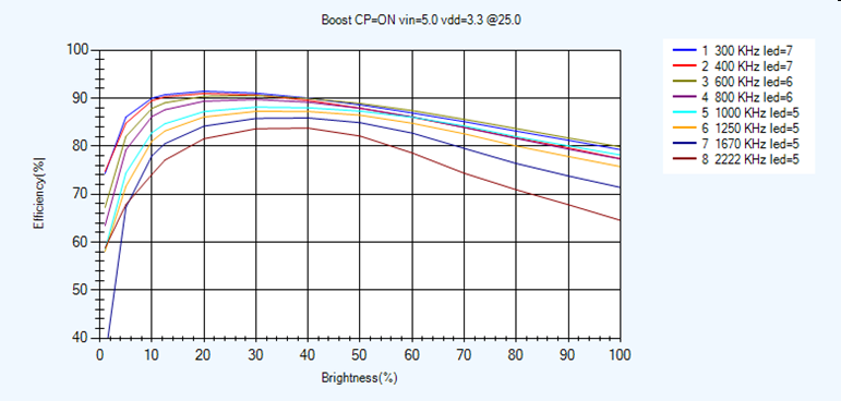

    This is the efficiency curve for Vin = 5V, and Vout =  18.5V(5 LEDs), 22V(6 LEDs), 25.6V(7 LEDs). Efficiency becomes worse at higher Vout which means high power loss turned to thermal issue on boost components such as SW FET, inductor, and diode.

  • Somehow, image file was not attached correctly.
    This is the efficiency curve image.
