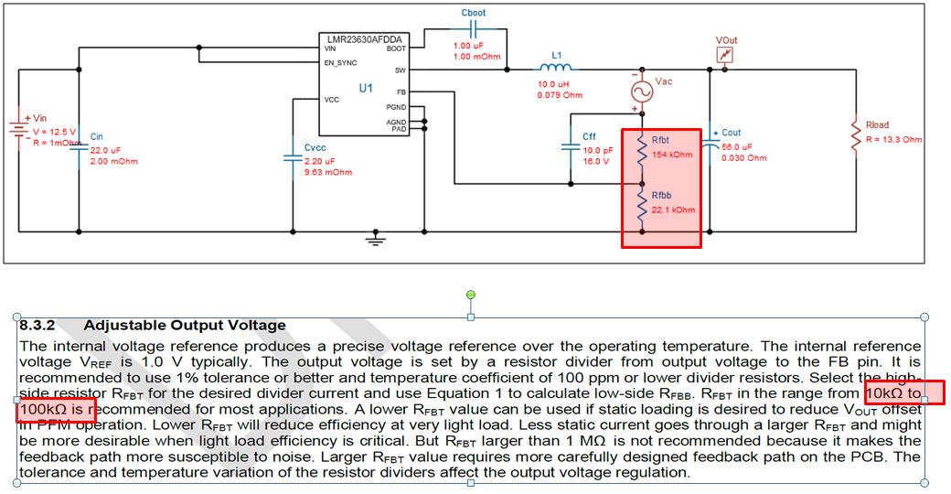

I did simulated LMR23630AFDDA in WEBENCH.
However, the Rfbt value differs from the recommended value in the datasheet.(Please refer to the below captures.)
Is it ok to use with simulation results?
