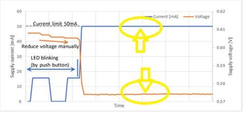

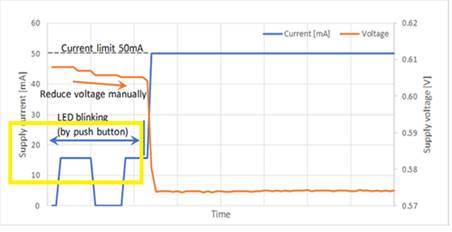

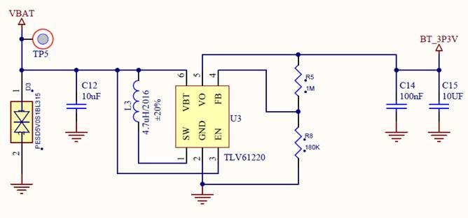

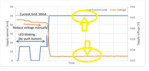

What is currently encountered is that when VIN is between 0.57 and 0.64V, tlv61220 will suddenly “keep” when Iout is loaded.
High current, but the input has not dropped below 0.5V, 61220 can not enter TURN OFF MODE.
If USER uses a battery that is already running out of power for the DEVICE, we fear that the BATTERY voltage will be pulled down to around 0.6V.
On the other hand, the TLV61220 KEEP has a large current and eventually leaks from the battery.
Would like to ask when the input power 0.57 ~ 0.64V, the output is 50mA behavior is correct?
PS:Test conditions for power supply set 50mA CC Output
