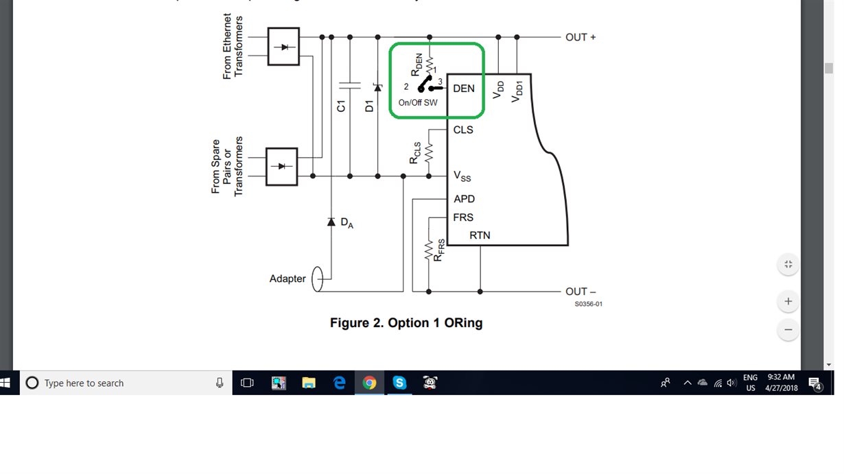

TPS23753: adding ON/OFF switch to controll power tern on
Part Number: TPS23753
I want to design a ethernet switch and it will be powered from PoE PD as well as external adapter. I want to controll the power on from ON/OFF switch. if ON my circuit should power on from PoE or adapter. when OFF circuit shpould not turn on fron either Poe or adapter. is it ok to connect a switch between DEN pin and DEN resistor, where DEN resistor is connected to VDD.
