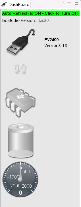

  • Hi Mark,
    To help clarify David's request above, he is asking what the image looks like on the dashboard of bqStudio next to the IC image (dashboard is not currently visible in the attached image above).  In the image below we can see a clip of the dashboard.  In this example, we can see the IC grayed out.  Does your IC look like this?  Is it colored (along with the up down arrows)?  To the right of the IC are ZZZ displayed or a locked symbol?
    If a lock symbol is displayed, the device is locked and needs to be unsealed.  If the device is greyed out, there is an issue with communication.
